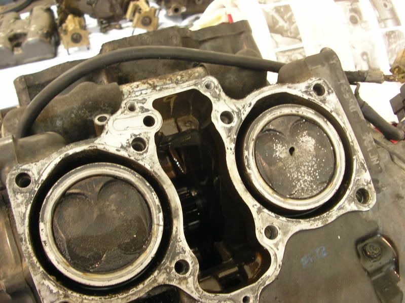

Got recovered the last 20 miles home and set about pulling the engine through to see what i could find. There is a lot of bits in the top end of these things isn't there..

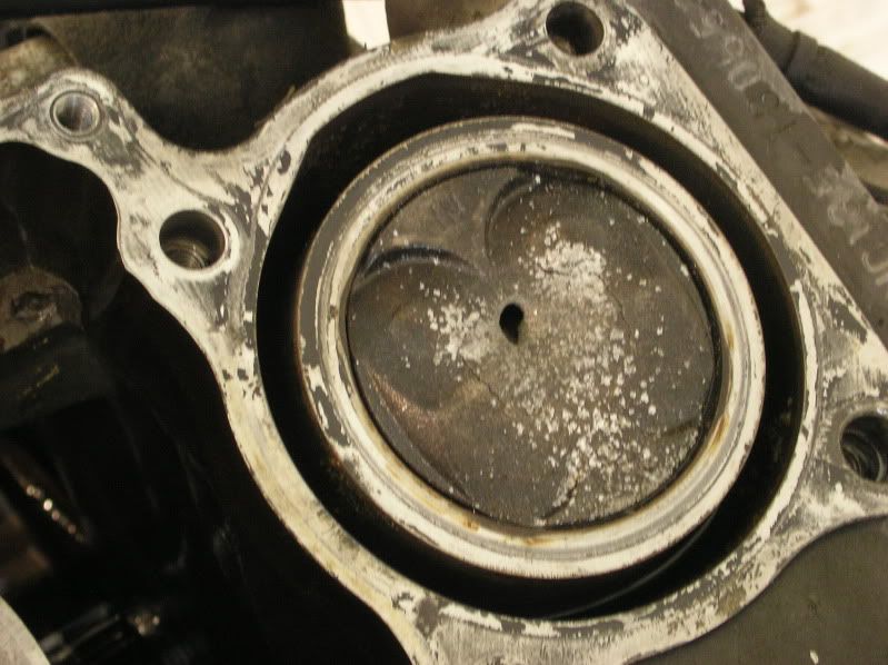

Someone please tell me the hole in the rear right piston is some gucci HRC weight saving mod i don't know about. If not i am guessing this may be the problem

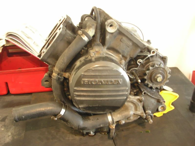

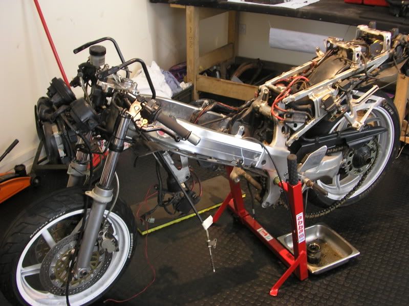

I had started of working with the engine in the frame (hoping to just replace a bust head gasket) but realised this is going to be a full engine strip so out it came...
I guess it would probobly be easier/cheaper to just get a replacement engine, but a week ago i would have said this one ran like a dream, so you never know what you are getting. Hence i have decided to have a go a doing a full engine overhaul on this one, depending on what i find when i split the crank cases.

Got any pics of the valvetrain mate? Did you melt that hole running lean or did you smack it with the end of a valve?

CMSMJ1 - you mention running lean could have caused the damage..

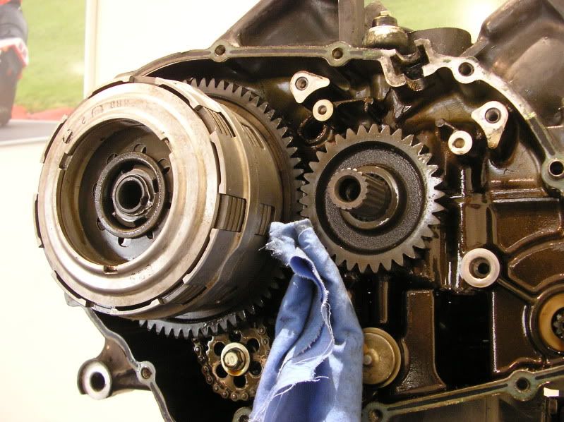

OK - onward. Busy working through the list of things you have to remove before you can actually split the crank cases and i have got to removing the clutch and hit a problem. I have unstaked the clutch nut flange from the input shaft and locked up the cluch using the primary drive gear and a rag (as per Mr Haynes fine book). My problem is that i still cannot get the clutch nut off! With some serious effort (using the correct Honda clutch nut peg socket) it turns and whils the clutch / primary drive are jammed solid it appears the input shaft is turning with the clutch nut????
Any bright ideas very welcome.

Oh and Mark/W00dzy - not running lean i am just putting it down to its intersteller milage and being pinned wide open for quite a long way - me bad

A melted hole like that is generaly from preignition from a hot spot in the chamber rather than detonation running too lean.
Check your spark plug and valves in that cylinder to see if one of them has been getting overly hot for some reason, exhaust valve not seating fully or spark plug with shattered insulator ect.
Detonation will normally shatter things from a shock wave effect rather than a nicely melted hole.

You might have to use an impact on that clutch. If it is turning the shaft, your clutch plates are slipping.
