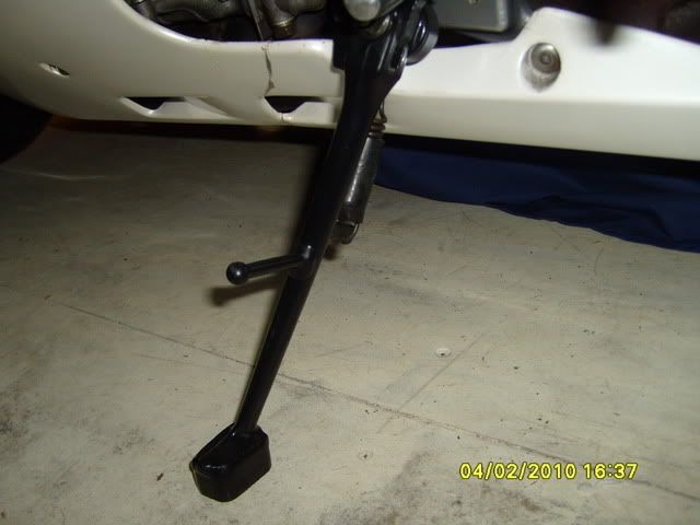

I tried a few different stands on mine which looked like they may have fitted but where all slightly out, i got a cbr400 sidestand from a breakers of which i got a piece of tubing welded in there (looked crap) In the end i just got a piece of ally welded to the foot on the original sidestand and once painted it wasn't too noticeable

hi mate, can u please post some pic of your sidestand and how the bike looking when its parked.cbr400rrn wrote:I tried a few different stands on mine which looked like they may have fitted but where all slightly out, i got a cbr400 sidestand from a breakers of which i got a piece of tubing welded in there (looked crap) In the end i just got a piece of ally welded to the foot on the original sidestand and once painted it wasn't too noticeable

The block on the end is 1.5cm thick, i then got the whole thing powdercoated so it didn't stand out as much.
The bike now leans over only as far as when the original sidestand was fitted
