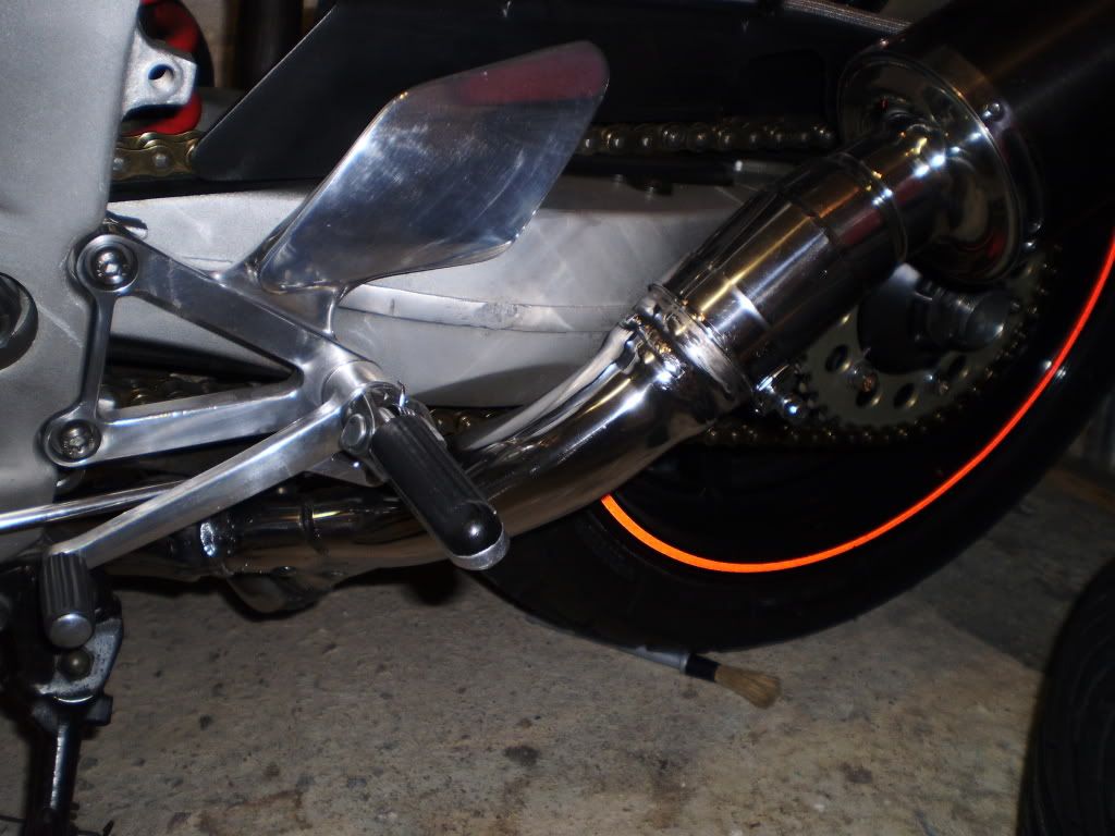

Spooky that..... I've just spent six hours taking my exhaust of and polisshing all the down pipes and collector etc. They've gone from the usual crappy brown to an almost chrome finish. I started with a fine wire brush in the drill then on to wire wool and then on to the bench grinder with polishing mops (best thing that I ever bought) Hard gratf but worth the effort in the end
Photos really dont do it justice though
