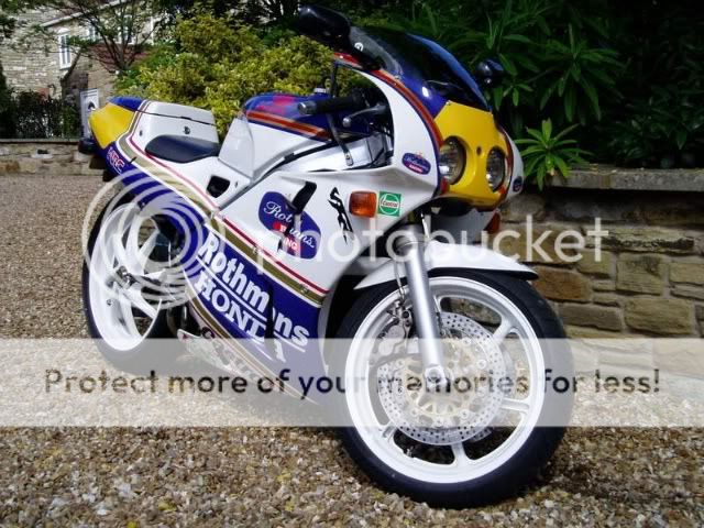

This is the Rothmans job I like...
Depends what you want doens't it? Are you going for a road scheme, a race scheme or endurance Jap scheme?
I personally like the AM/PM scheme and the core Honda RWB style.

I like that a lot cms, is that yours?? are they rc30 mirrors or ns400??

Not mine mate..I wish it was..it is cool!
Think it is a proper RC30 - but has USDs...

It could be, or it could be an RC45? The look like RC45 forks & Kit.. dunno about the wheels though and I can't see any plastic air-ducts from the front to the tank.. The rears more RC30 shape bure theres no key hole in it.CMSMJ1 wrote:Not mine mate..I wish it was..it is cool!
It's a custom :D
Heres an RC30 rothmans.

I think you maybe right, i can see a metal stamp on the frame , dont rc30's have that?? I love that back wheel!!

Lots of Honda's do, but both the RC30 and RC45 have the VIN details fixed to the frame on a metal placcard in that spot :)ibby4585 wrote:I think you maybe right, i can see a metal stamp on the frame , dont rc30's have that?? I love that back wheel!!
It is infact an RC30 though, with RC45 parts and even NC30 parts (headlight)
http://www.users.waitrose.com/~gmac/VFR ... /index.htm
Guy who owns it website :D Sadly This RC30, and all of my spares were sold in July 2009.
I was right about the RC45 front end tho :D
This bike is a 1989 version VFR750R (RC30) K model.
It is a UK model - not a European or Japanese import. The UK models had an unrestricted engine, whereas the European and Japanese models had restricted engines.
I have owned it since July 1993.
It has never been raced, used only on the road.
I have had some great trips on the bike: for example, to Spa in Belgium (to see the 24 hour endurance race), and to Assen in Holland (to see the grandprix).
It has always been 100% reliable. It has never had a mechanical breakdown - or even a puncture.
The RC30 in its current configuration:
The fairing is a replica, drilled with air holes/vents for extra cooling.
The fuel tank is an RC30 original, enlarged and with twin chrome filler caps.
The seat unit is a replica, but it has an original seat cushion.
The Dymag wheels have been strengthened for road use. (Rear wheel 5.5 inch wide/17 inch diameter, front wheel 3.5 inch wide 17 inch diameter.)
The small two piston rear brake caliper is a replacement. The brake cable is specially modified so it can run through the swingarm (which has been drilled to allow for this).
The front calipers are "AP Racing" six piston brakes, with master cylinder.
The front discs are also from "AP Racing".
The front end has been converted to an RC45 setup (which includes upside-down forks, headstock and all relevant attachments).
The Ohlins racing shock absorber (with remote reservoir) has an inbuilt ride height adjuster.
It has a single headlight RC30 fairing conversion (using the NC30 left hand headlight and parking light).
The upper radiator is new.
The standard filter has been replaced by a K&N filter.
The standard nut and bolt set for the engine and front fork setup has been replaced by a complete set of titanium nuts and bolts.
The standard exhaust has been replaced by a Termignoni complete race exhaust system (in polished stainless steel).
The original RC30 rearsets have been replaced by RC45 racing rearsets.
