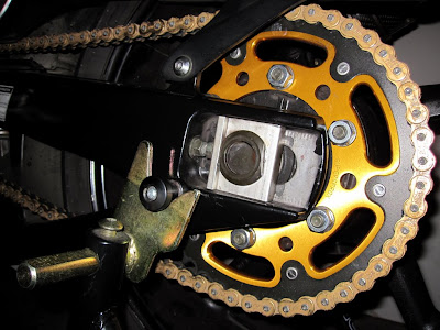

I found that sprockets from CBR900 almost identical, only holes for mounting bolts 2.5mm bigger. All have diameter between mounting holes, all have same 525 size, but I can get 42 teeth for cbr900.
Here is size of NC29 sprocket
Here is size of cbr900 (1996 to 1999)
Will be appreciate any information about such conversion, because I like to try Supersprox rear sprocket.

Could you make a set of cylindrical spacers of OD 12.5mm, ID 10.5mm?

I'm thinking to make set of sprockets fixing bolts for OD 12.5mm. What I'm worrying about is the length between mounting holes.Wozza wrote:Could you make a set of cylindrical spacers of OD 12.5mm, ID 10.5mm?
