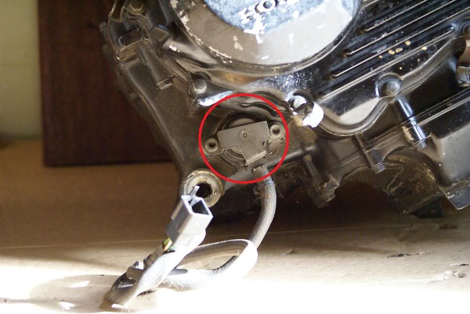

This pic is of the goosed NC24 engine which has been removed from the bike. You can see the tang, and the wire for it which seems to splice into the braided sheath with the green plug. I reckon this is for the neutral switch:

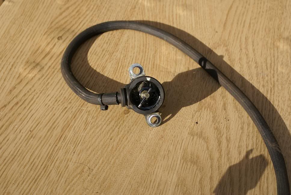

This is a pic of the corresponding location on the replacement NC21 engine. Instead of the tang, there is what appears to be a mechanical switch, a braided sheath with 5 wires which terminates in a black plug:
On the NC24 engine, the wire from the tang (1st pic) seems to form part of the green multiplug, which has 6 terminals on it. On the NC21 engine the green multiplug only has 5 terminals and, as you can see from this pic, it does not connect to the switch shown in the previous pic:
This is the NC21 engine with the switch removed. The shaft can be clicked one position forwards and one position backwards, which is why I think it must be the neutral switch:
This is the switch:

Interesting, the plot thickens.
You are correct in saying it is the netrual switch, pictured on the NC24.

You'll need to match up the wires and splice them together im afraid. Still thats not standard *confused* but intrigued

As i wrote before, You'll need to match up the wires and splice them together im afraid.
http://www.jacksons-lair.co.uk/VFR400RH ... Manual.zip" onclick="window.open(this.href);return false;
The NC24 owners handbook is there, it has the NC24 wiring diagram, you can use it to find out where the wires go, you'll have to cut them and add some spades.
Have a search on the forum for NC21 problems and message some NC21 owners and see what their neutral switch looks like..
-Edit-
Had a quick look at the NC24 diagram, the block that houses the Neutral Switch (ニュートラルスイッチ) also connected to the Oil Pressure switch (オイル圧力スイッチ) and the Pulse Generator (パルスジェネレータ )
You'll see them in the lower right hand corner of the diagram. I'm goign to presume that four of the wires in your other plug are the pulse generator wires and the other one is a neutral switch.
They may even be the same colours, just match them up, if not a little educated guess work is in order.
