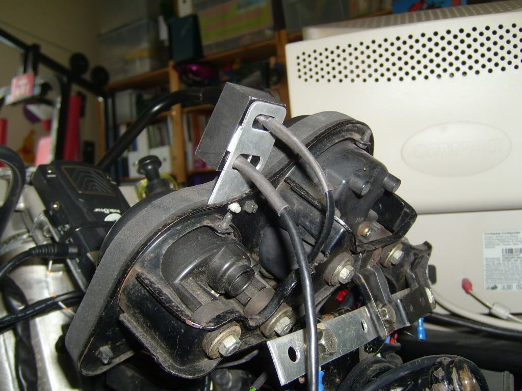

I know what you mean Pleiades, looking for 7th! Yes I do only use it on trackdays.
Thanks for your suggestion Stickshift, after I'd used a normal length of stranded wire I tried a shielded cable, but it made no perceptible difference (I wish I had a 'scope to have look though!)

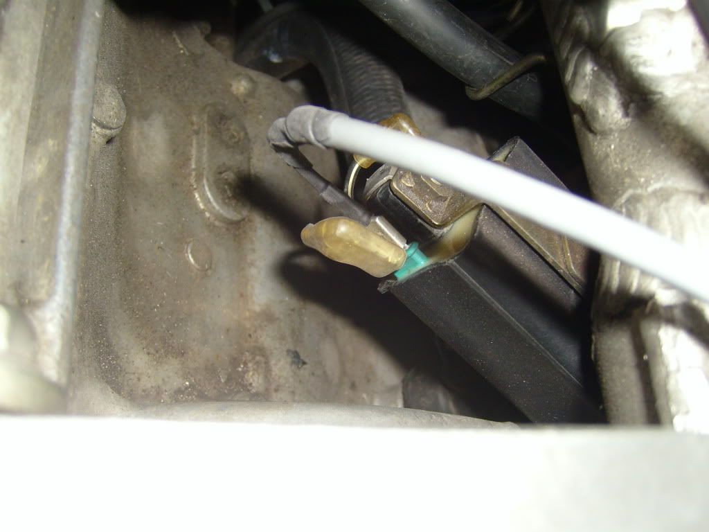

I have now taken the input from one of the coil connections and it appears to work. ie it is now reading engine pulses. After reading the programming instructions a meeellion times, I am able to program it, but I am unsure what to do once you're in 6th gear, it displays 'n' and I wait for the 15 seconds, then turn off the ignition?
Once I do this it works erraticly, although I haven't ridden it yet, just testing on the paddock stand. When sorted I intend to put the magnet on the front wheel.
I too have had no response from Biketronix to my queries, which forces you to read and re-read the instructions!!!

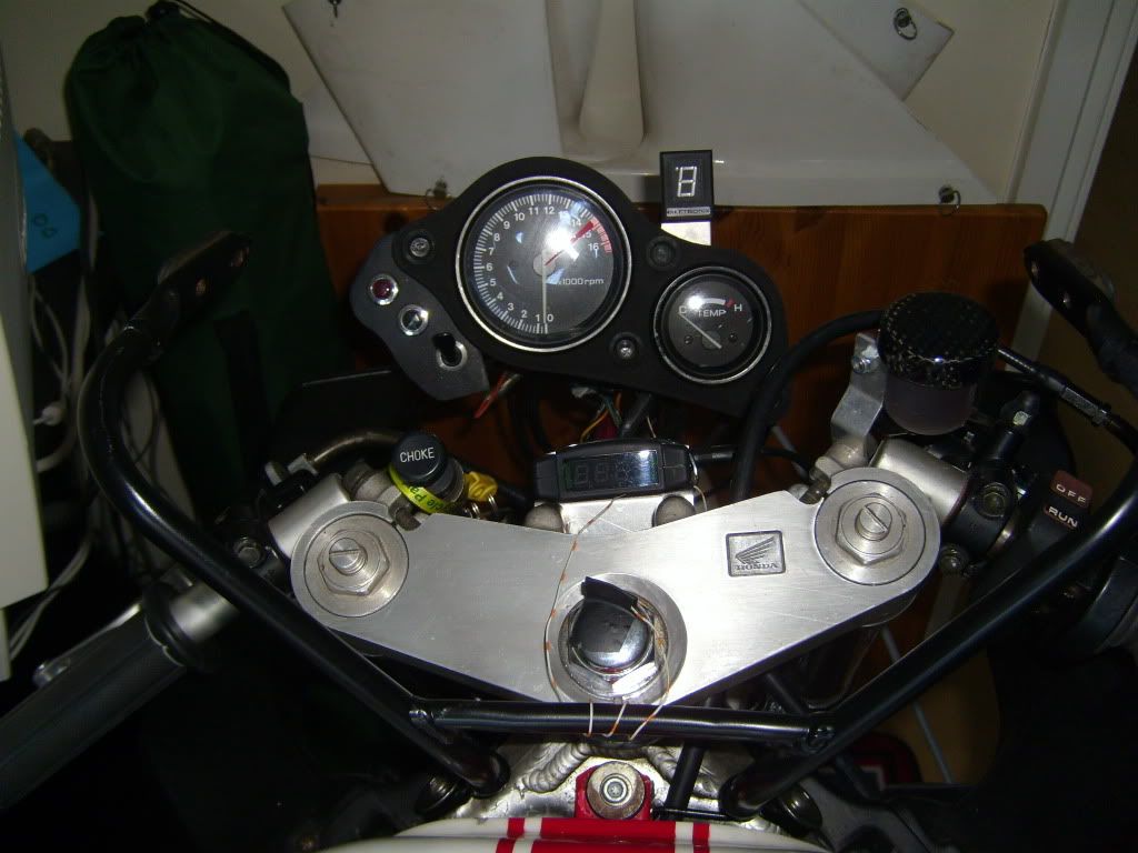

Picture of dash layout:
rear of dash showing simple ally bracket pop-riveted to originall bracket under the foam!
picture showing use of piggy-back spade connector to connect to the coil.
