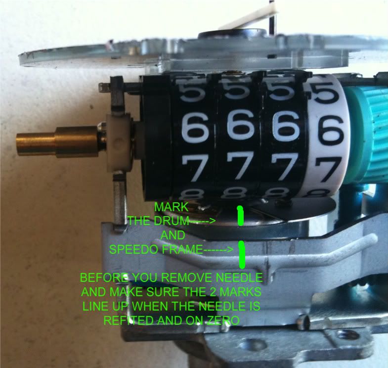

i will asume you can use spanners and screwdrivers to get the clock off and down to just the speedo head. there is not much to it but the big one to watch is the needle has preload on it and you have to mark where the drum sits in relation to the frame before you remove the needle otherwise your speed will be way off!!!

then using the marks to align the drum i press the needle back on.

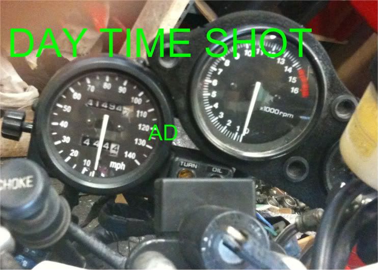

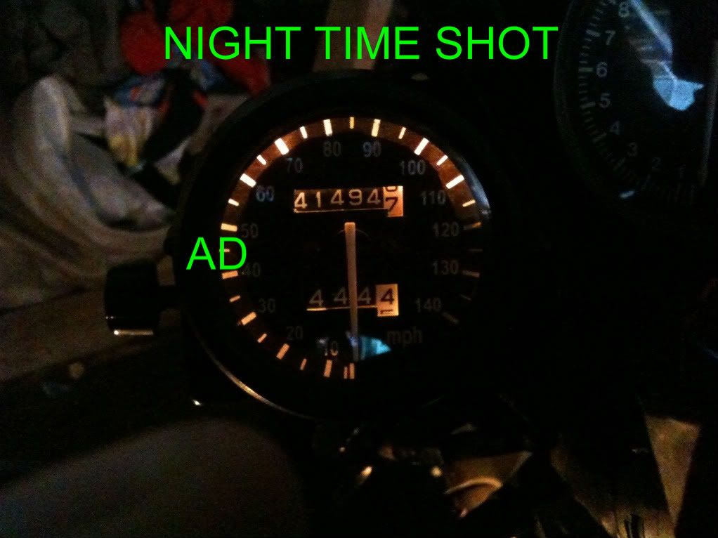

you should then have something that looks like this...

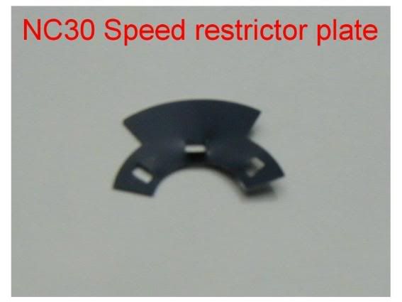

before you rebuild you can take advantage of having the clock stripped and delimit your bike as per
REMOVE THIS PART FOR +120MPH!!!

then build it back up and you will have something that looks like this

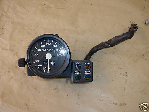

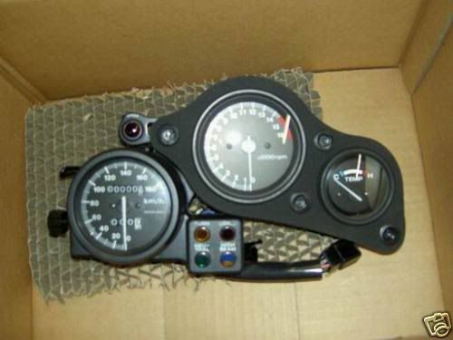

Re: FITTING EBAY STICK ON SPEEDO MPH DIAL
when fitted to the cbr400 the 60mph is just below the 100kph mark. i.e about 100k = 62 mph which is correct.
also 140kph is at the top on the cbr400. on my dial (for both) 85 is at the top. 140kph is equal to 86.9mph.
as far as i am aware they are the same speedos. any minor difference will be soaked up by the fact that speedos are not overly acurate to start with.....
if anyone can canfirm otherwise please let me know.
just found on ebay..... they look the same to me....
vfr400 clock
cbr400 clock
