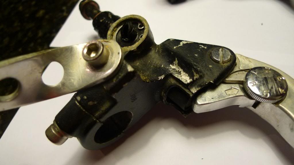

It took a beating in the crash:

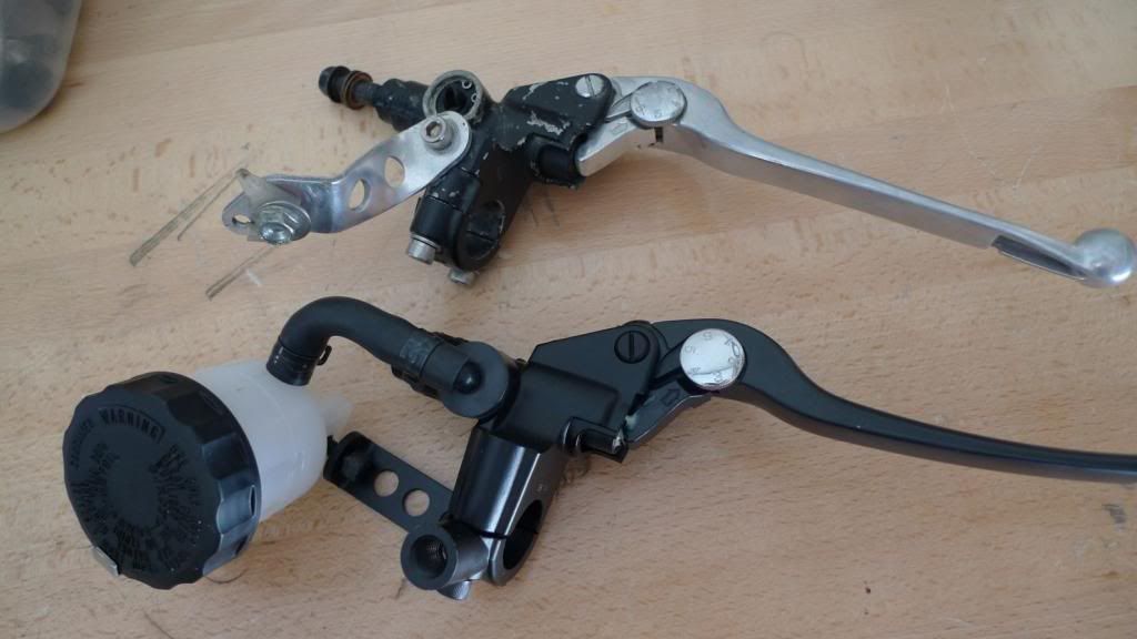

So (as well as a rebuild kit) I ordered a new one - not from Honda, but from Nissin:

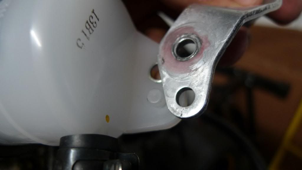

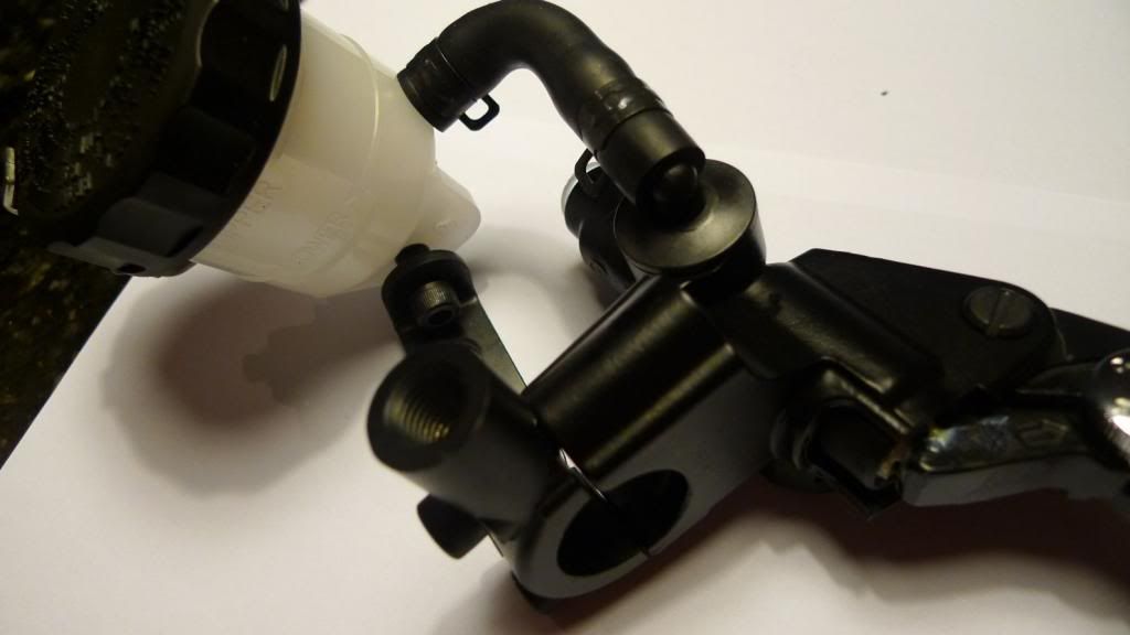

Note an important difference? Have a look at the beat up NC30 one - it has a reservoir mount attach point on the cylinder casting. The Nissin replacement does not. Great. The new Nissin has only a mirror mount, but not on the cylinder. It did come with a sort of universal mounting bracket, but I think with no real place to mount it. The mirror hole seems reasonable, but no-can-do .. that puts the reservoir about the same place as the fork is ...
Other things were differences as well:
Why did I not just get a second hand NC30 master and then buy a rebuild kit? Because a second hand one plus rebuild kit would have cost me a fair bit more more than a brand new one. So I went for new. But .... just for good measure I also ordered a rebuild kit from the same people at the same time in case the new one was not right.

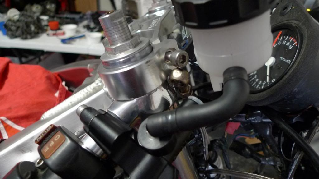

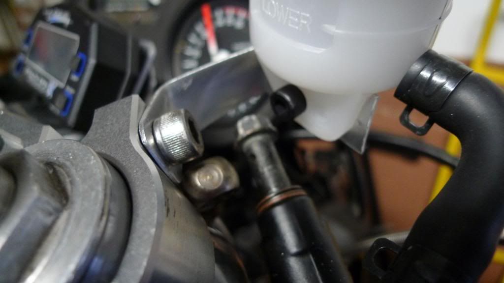

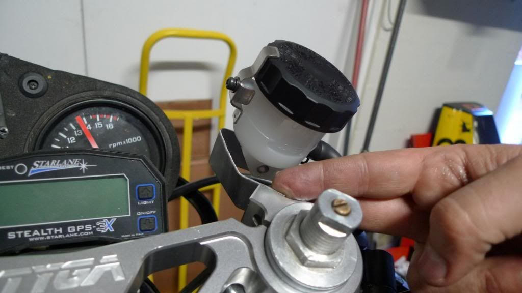

The only reasonable place I could find to mount the reservoir from is here:
I could have used the mirror mount, but that makes for a very loooong mount.

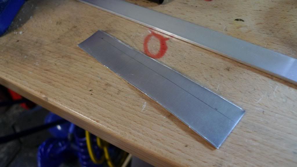

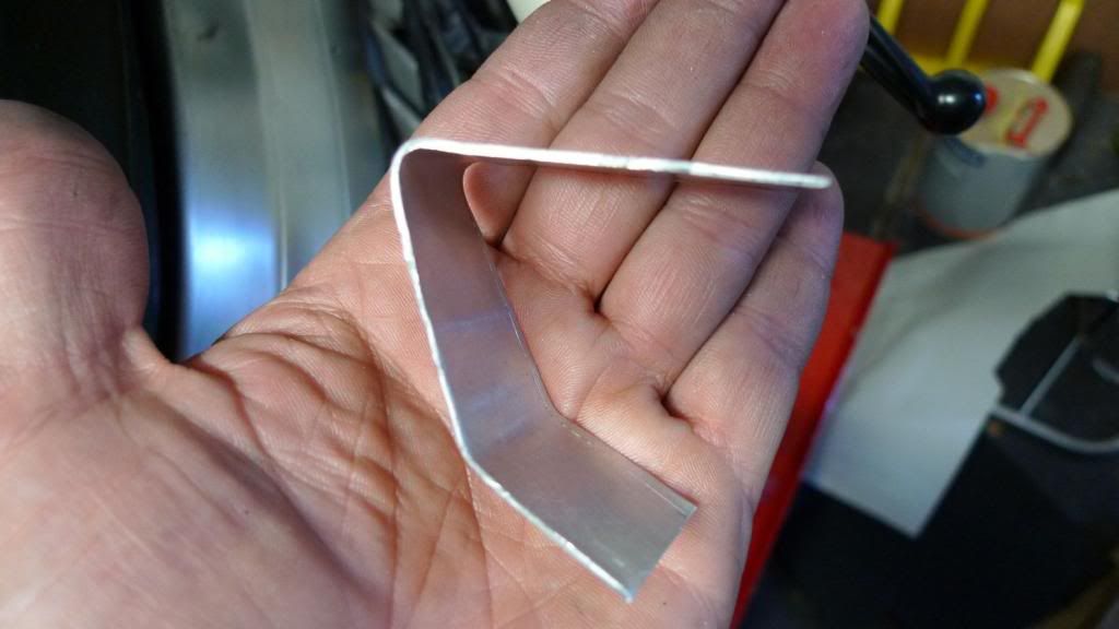

I've got a strip of good thick 20mm wide aluminium to make a real mount bracket from, but first, I'll create a prototype from a scrap strip of nice thin and bendable aluminium cut to 20mm width:
It'll need to be twisted some as things don't all line up:
Seems roughly about about right:
So I drilled it to try a real mount and figure out roughly how much to bend stuff. Not too bad, so tomorrow I'll cut up a real one.

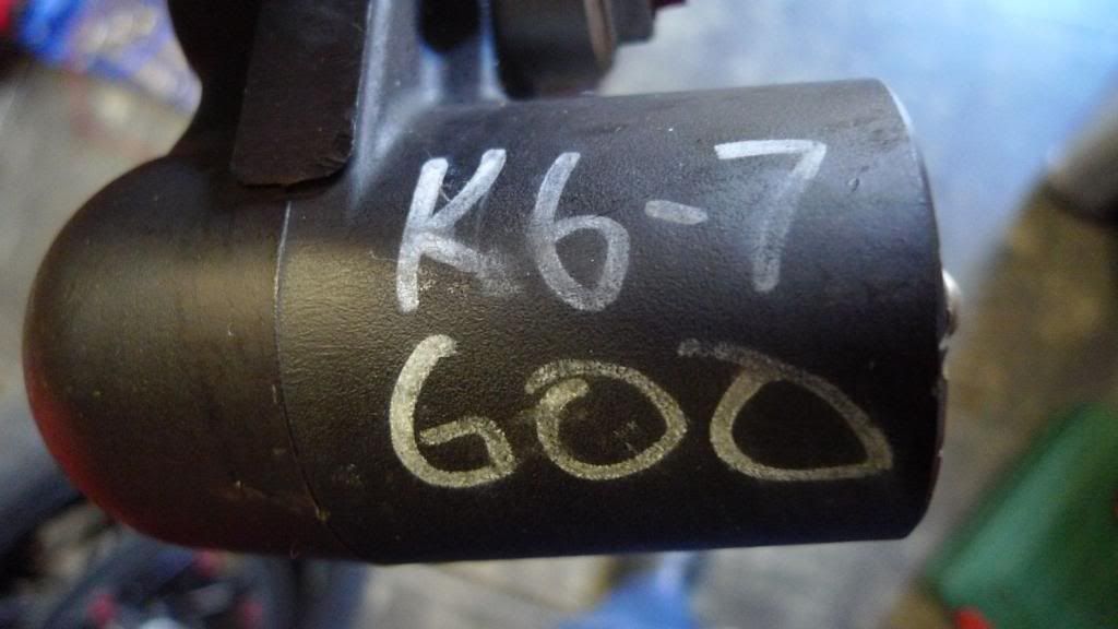

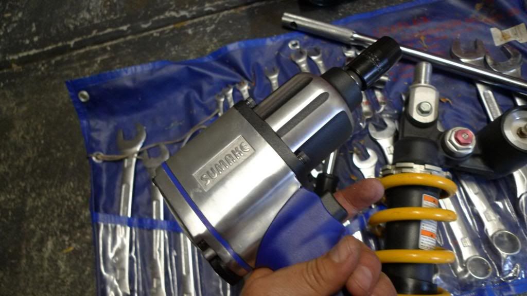

So the previous picture of the GSXR shock is my latest attempt. I went to the wrecker this morning to look at buckets of GSXR shocks. The GSXR 600s and 750s of that time used the same shock.
Initially, I was after a 2005 shock. I understood this was the one to get. However, I saw some specs the 2005 online and it had it at about 335mm - which is waaay to long - so I had doubts about it. I had also read the 2005 had a 7.3 spring on it which seemed really soft. The later models had a 9.5 on them so I was keen to see if the later models were the same dimension as the 2005.
Nope. I was disappointed to find the later models were much shorter than the 2005 model ... that is, until I measured and confirmed the 335mm of the 2005! It was actually the later models that were the right length for an NC30. The K6/7 shock picture above is 315mm in length, and unlike the K5 (2005) is has hi/low speeds compression damping. The K5 looks a more basic shock. So ... funnily .. the 2005 model does not look the one to get at all.
I had the opportunity to inspect a BMWS1000RR shock also and it seemed a nice unit, but two local shock specialists said they would favour the GSXR Showa over the BMW Sachs unit. It seems also there is a greater pool of knowledge on tuning Showa compared to Sachs.

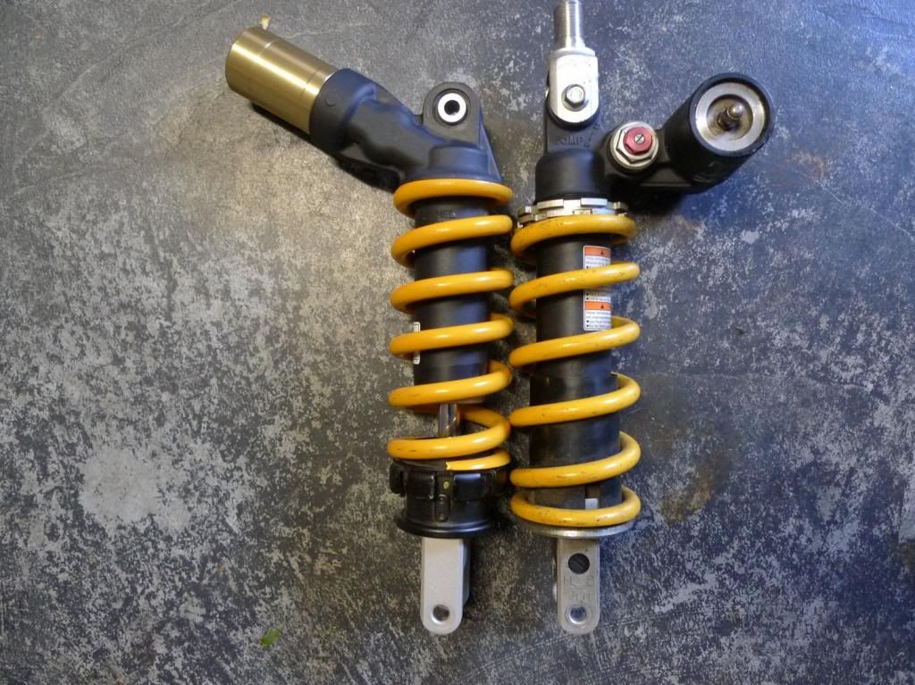

So here is the CBR (left) unit vs the GSXR unit (right):
And vs the OEM NC30 unit:

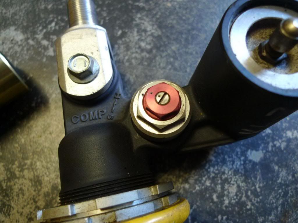

The hi/low speed compresison adjustment:

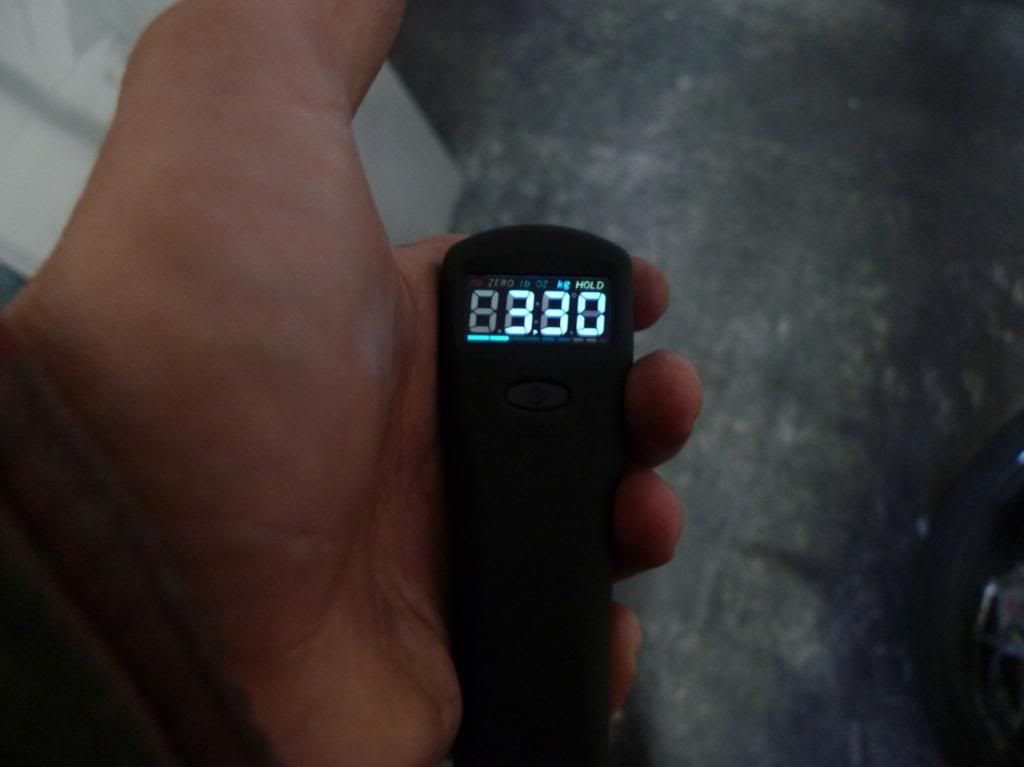

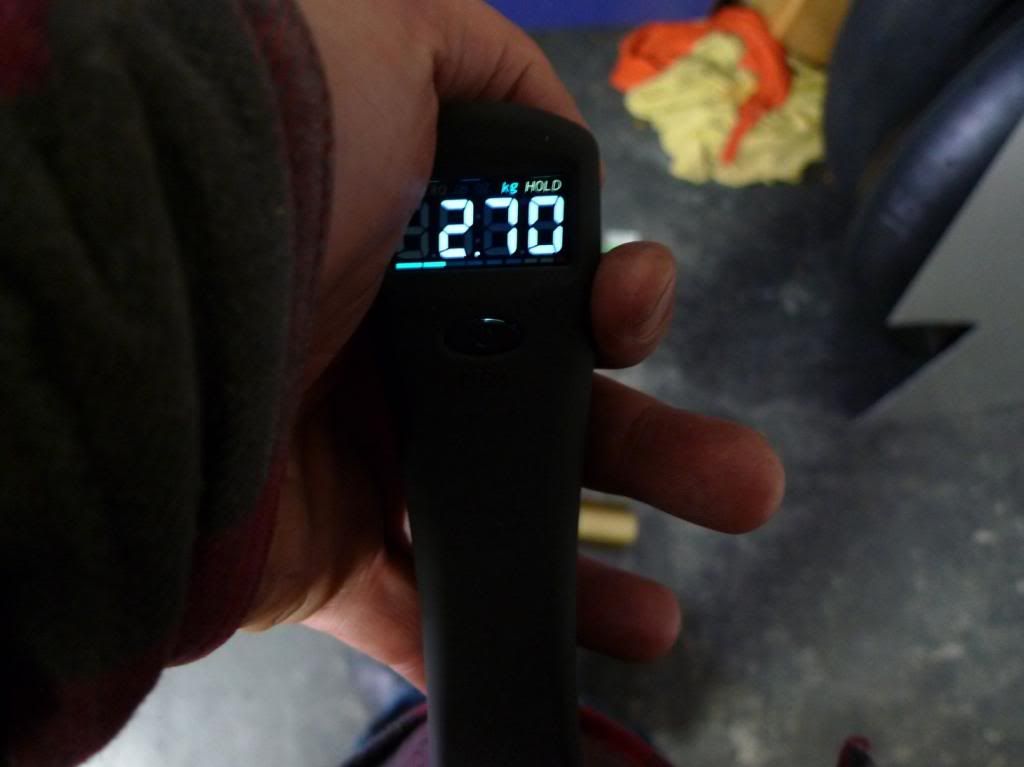

Both the CBR and the GSXR were the same weight at:
and therefore were lighter than the OEM unit at:
The top mounting bolt was put in there by Dog Himself so I had to bring out the big guns to loosen it:

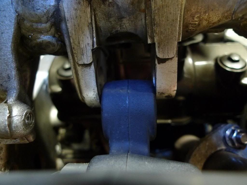

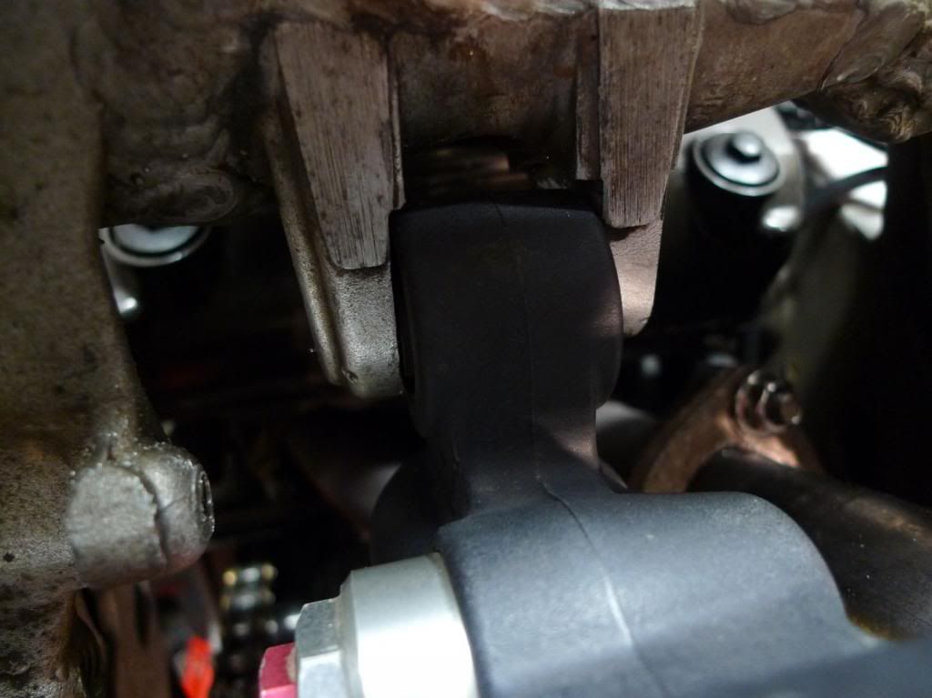

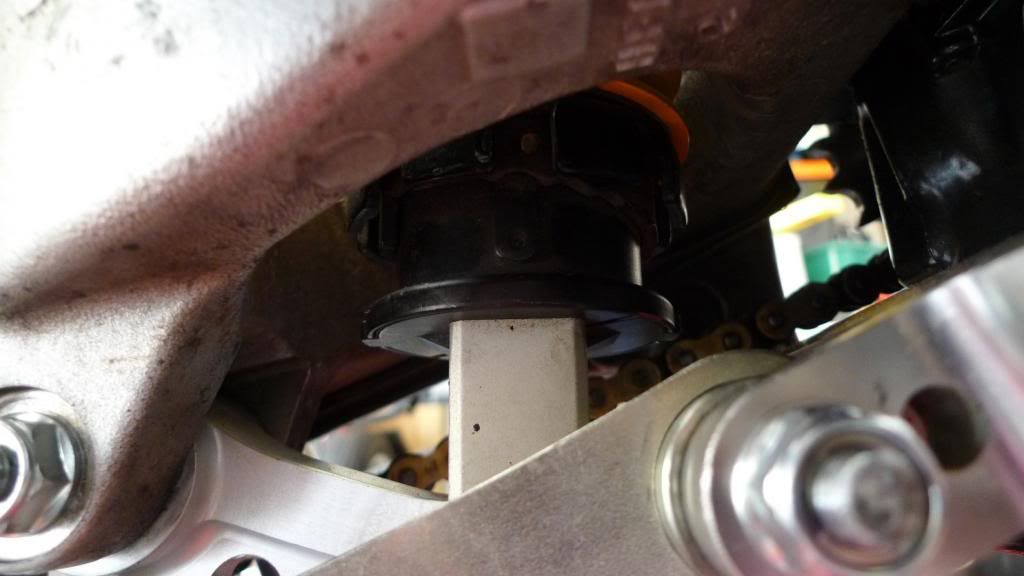

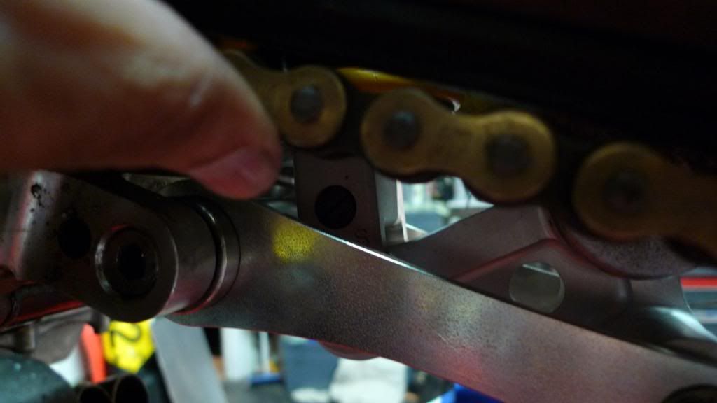

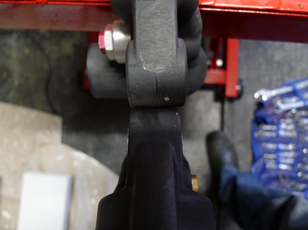

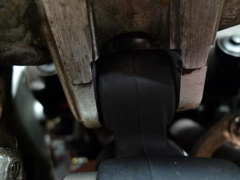

An initial test fit provided the first disappointment. Despite taking measurements with me to the wreckers, I had heard the GSXR shock was a no-mods fit so I didn't double check. Oops:
The GSXR shock is a bit wider! However, the mount may be wider, but the actual width of the bolt sleeve was only about 1mm-1.5mm greater than OEM or the CBR1000 shock:

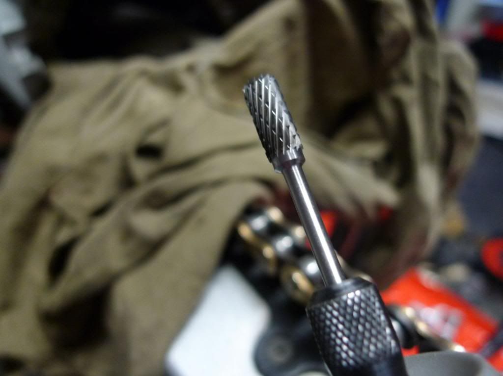

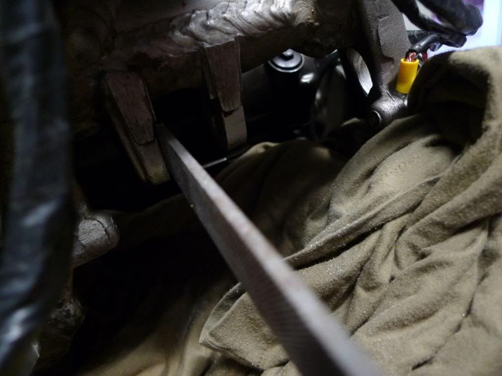

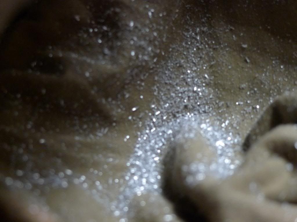

Initially, I really didn't want to make any frame mods, but 1-1.5mm is no big deal ... so figuring that if the GSXR shock was not great I'd try the BMW .. which needs frame mods, I thought scr*w it, in we go:
... which didn't get anywhere too quickly, so again I pulled out my cheap-as-chicken-sh*t carbide dremel thingies and set into action. *Man* these thing are great for like, $20 or something:
Bits of frame shock mount ... no more "pining for the fjords" ... :
getting there:
.. and done :

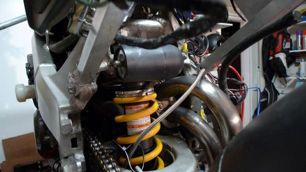

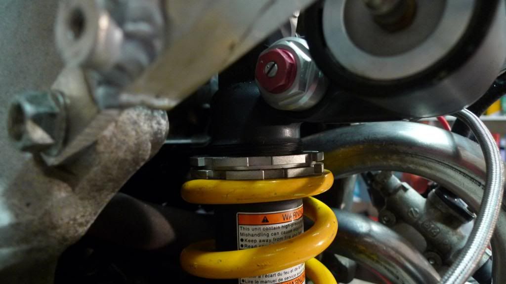

Okay ... it goes in and (not shown) my current battery box seems to fit:
The compression adjusters are a little awkward but not too bad:
.. and the rebound adjuster is on the chain side! ... but manageable:
Voila!:

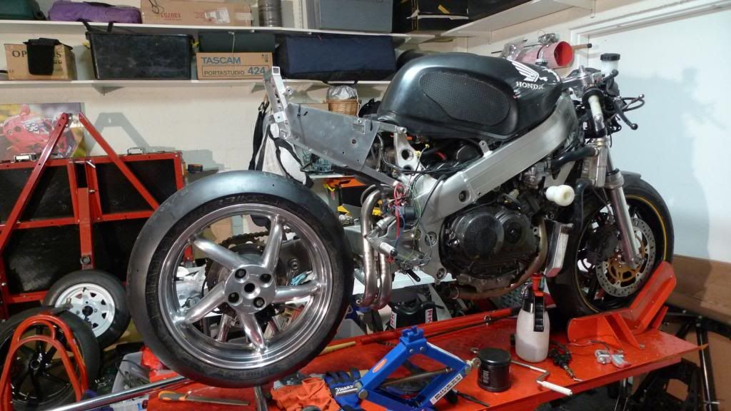

Funny, I had the OEM shock in to keep things up after I took the CBR one out. So, this time to take it out, as usual, I raised the rear end off the ground etc etc. But to get this one *in* I had to raise it *further*!!
I've got a quote for re-springing and re-valving the GSXR shock which was not cheap, so ... I am hoping the way it is with the 9.5 spring on it will do the business. A sag setup will reveal more .. and I'll likely have a few questions here.
I'll do the sag set up at the weekend when I can rope in the support team.
