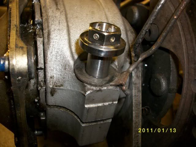

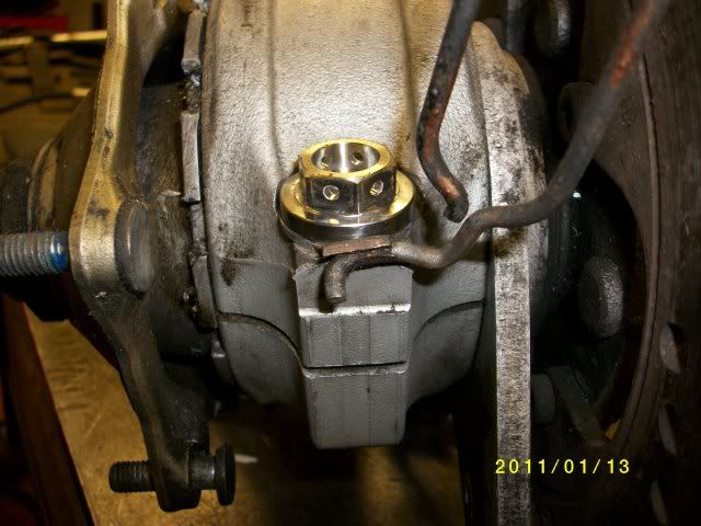

tested the hub nut and hub pinch bolt both are Spot on,
only issue ive had is the bloody hub is a nightmare to drill so going to get some better 3mm drill bits,
ill also put all the torque settings to save you having a mooch through.
Hub Pinch Bolt, 17mm hex, 3mm lock wire holes, 55nM
Hub Nut, 46mm hex, 3mm lock wire holes, 165nM VFR - 205nM RVF
Wheel Nut, 36mm hex, 3mm lock wire holes, 120nM
Yoke Stem Nut, 140nM VFR - 105nM RVF

porndog you beat me to it,
But i'v got to show mine off just the same,
And say a big thanks to Kayla,We must get some Kissing smilies,Then we can all send them to Kayla,thanks again.
The swing arm don't do them justice,it' my spare.
