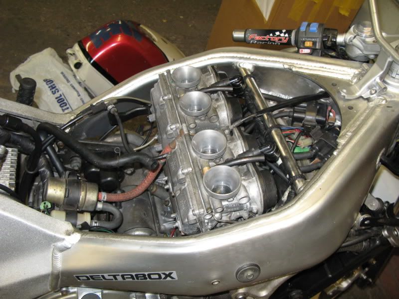

Started to put the carbs on but they've been off for a while and will need some more wiggling to get them to sit right.

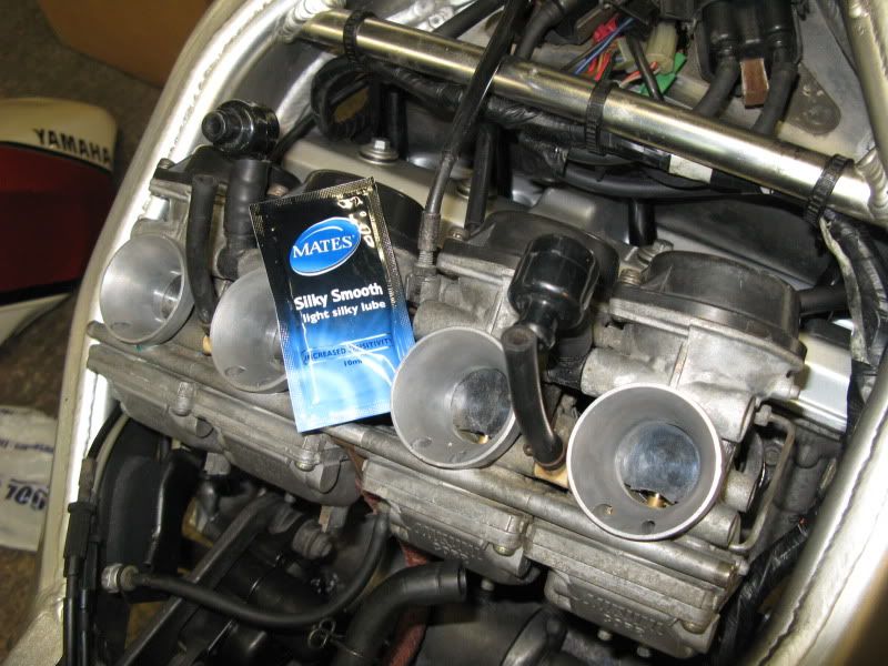

The carbs were being a pain to get on, so I tried a bit of lube, after a lot of pushing they went in

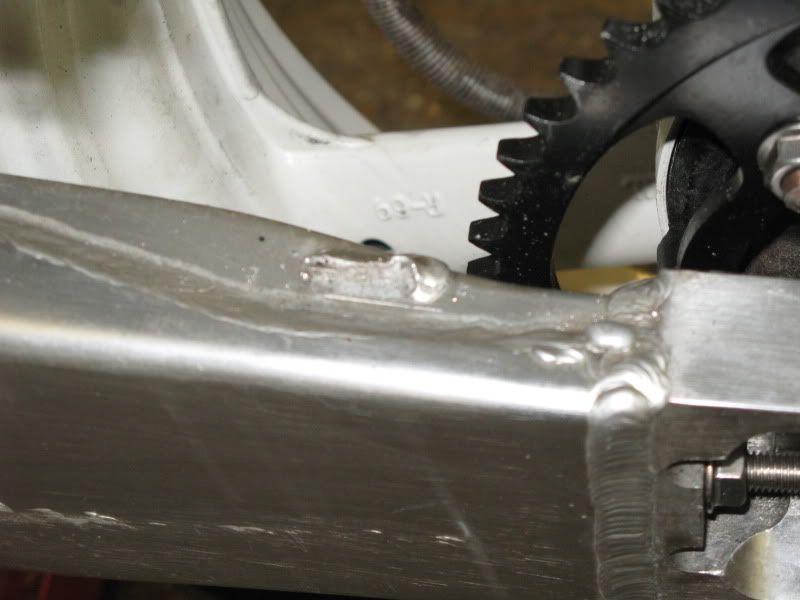

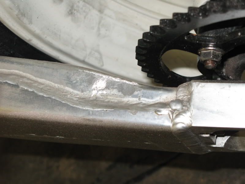

Then I had a power tool job. I needed to grind down the old ally weld where the chain guard bracket was. Next I'll make a new bracket and get another guard, then I can put the chain on.

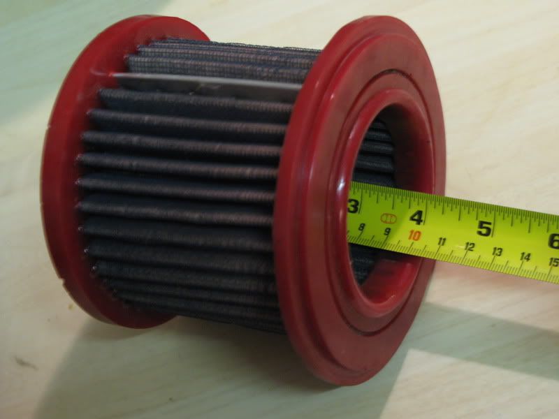

A bit of a result - I opened up the airbox to clean it and found a posh filter there, it fits nicely too
I've done a bit of chasing to find out exactly what it is for you guys and it turns up to be a BMC FM174/07 It's the filter they make for the FZR600 but without the two (top and bottom) rubber rings. I'm trying to find a retailer but it's an older filter and most people stock from the R6 onwards
I'm told theses are no longer available
