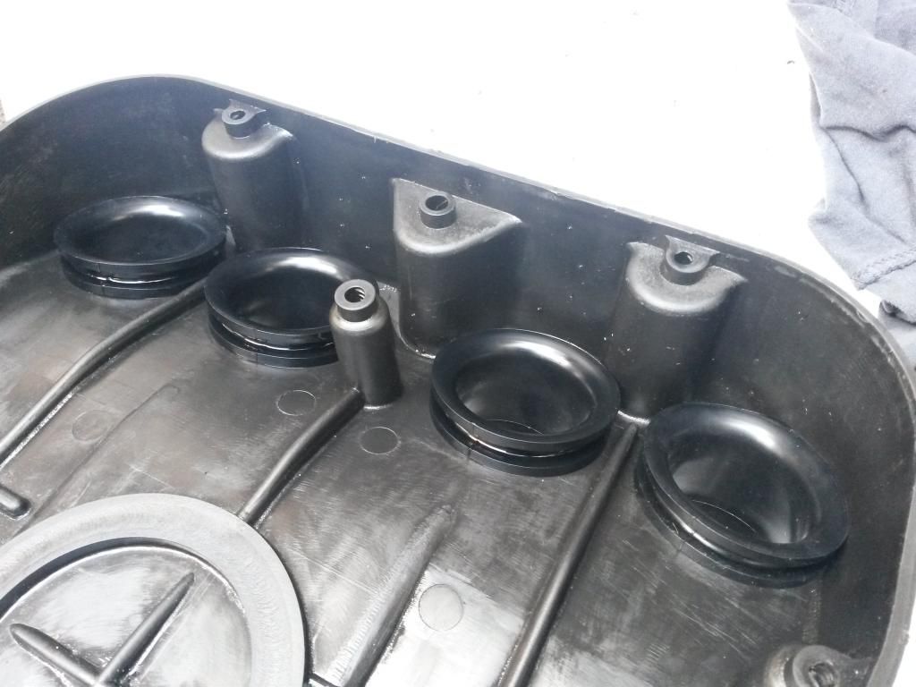

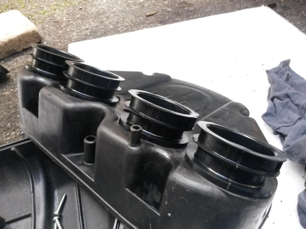

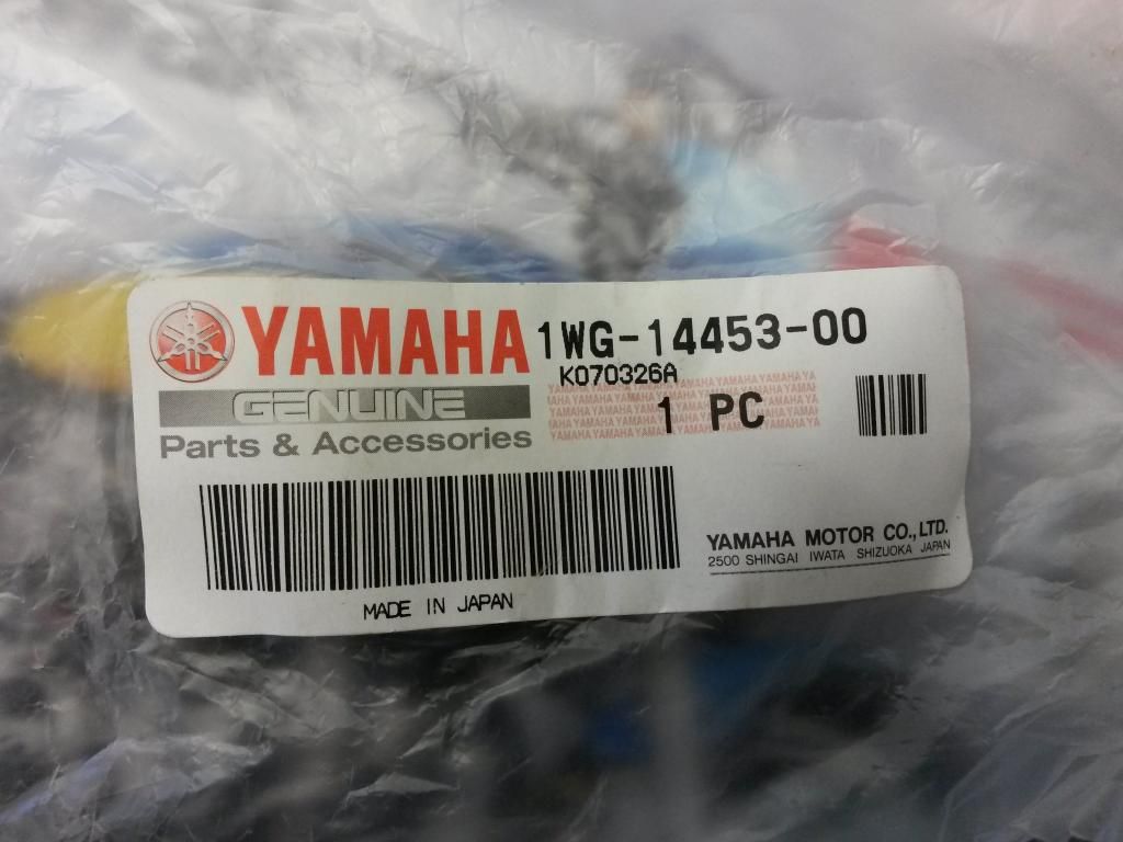

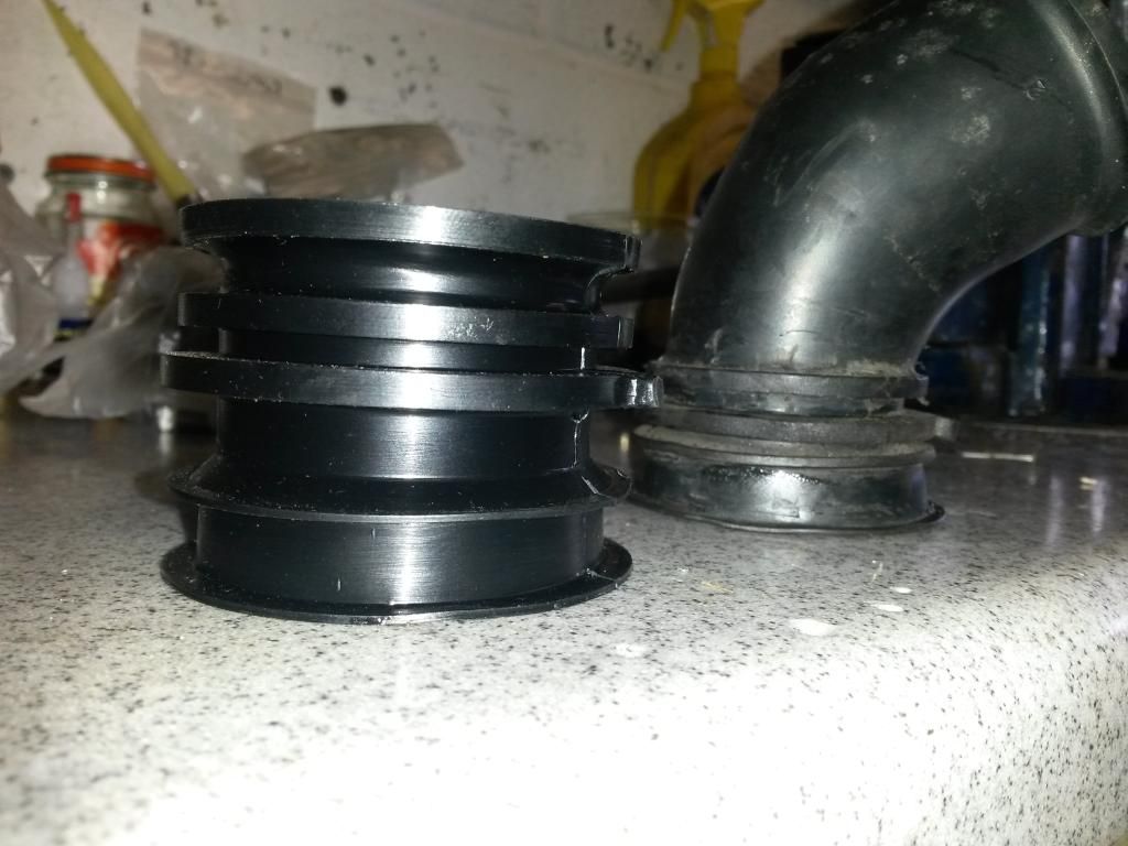

Re: FZR RRSP 3TJ7
Thanks to andy (laminator) who donated a nos set of airbox rubbers for a earlier model I have for the first time since owning the bike a airbox that fits. Thanks pal
different in shape but fit perfectly, tick over is dead steady now and the revs no longer hang
only mod I did was cut off a lug so the clips sat flush

Well you eventually got it going right anyhow .
Mind you fooked about and disheartened yourself enough times.
Chris informed that the mod worked with Genesis intakes and the parts were available for pennies at the time.
Just in time for winter Eh !
