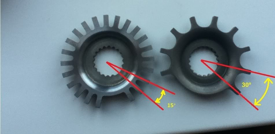

I also fabricate different timing wheel to get better timing detection.

Here is some details about timming\trigger wheel changes. I have added some details in English.
Not tested yet with Microsquirt. I'm little busy with PWM stepper motor controller, because previous one didn't work properly with Microsquirt V3.0.
http://www.youtube.com/watch?v=_aXfGIMGcN8
