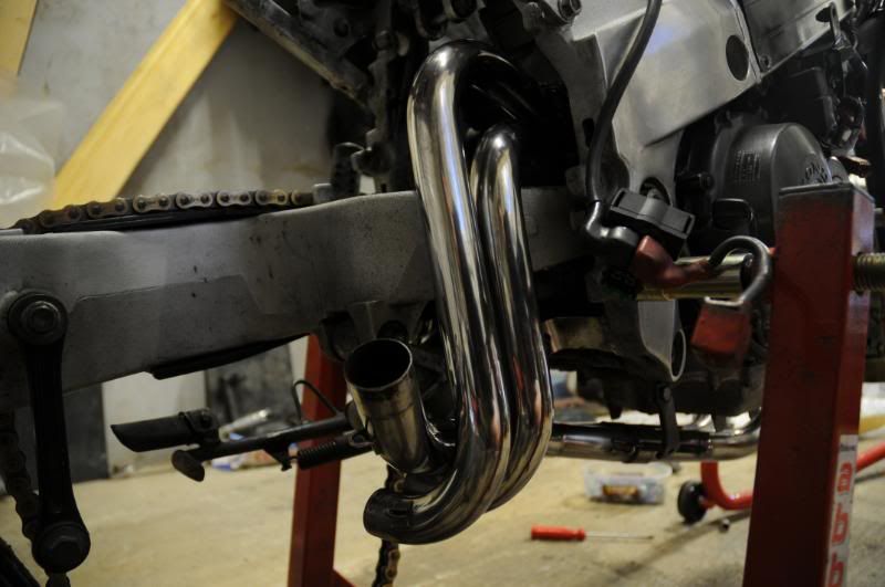

Wheels are back from he powdercoaters, discs are re-fitted along with the new bolts. Got the bearings in, some alloy captive wheel spacers and polished the pipework up a bit. The damaged likn-pipe and can are away to get repaired today so that should be back soon, then it's time to bring it all together and park it up for a few more months.

Shiney polished pipes look cool! Did they take long to clean up? what did you use?
