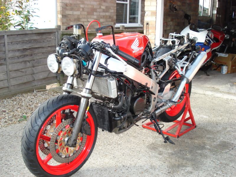

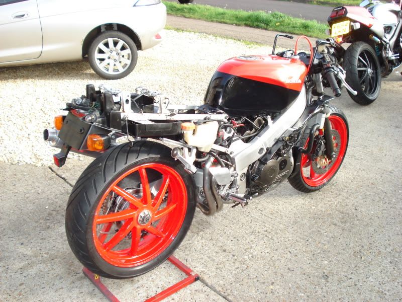

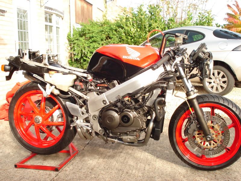

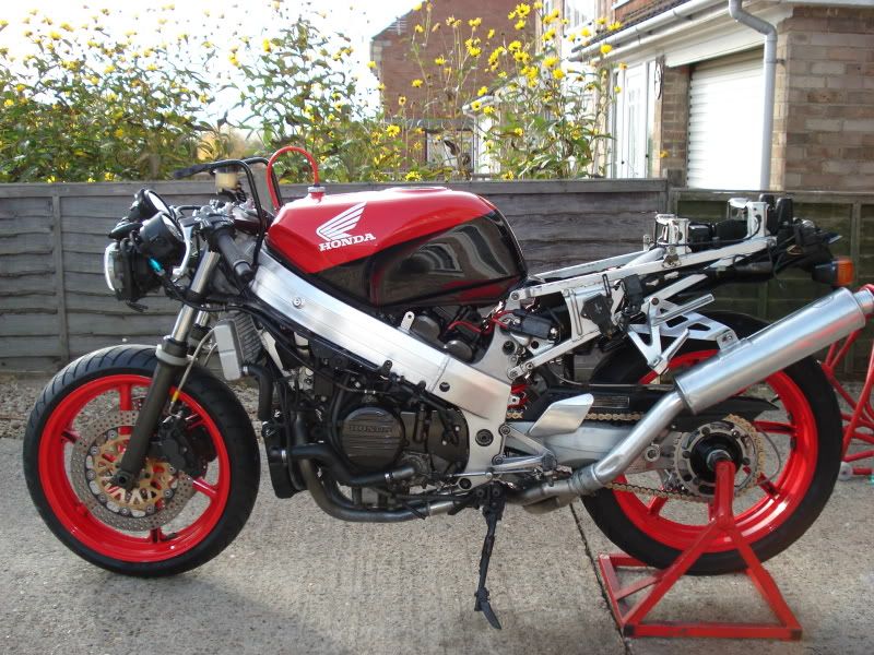

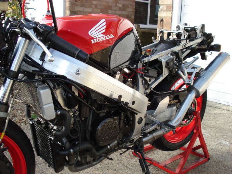

Right finally got the wheels on, and wheeled it out for a few photos and a start up. Carbs seem bang on, but the revs are hanging at around 3-4k so need to check the carb rubbers are up nice and tight or the throttle cables are sticking slightly simple fix though!!
Pics!!
Pics!!

Hi Kris,
Is that a scuff on the swing arm just behind the heel gaurd? I have a scuff that size in the exact same place. I wonder where its come from?

Yeah its a slight scuff, a couple of mine have them, i think its when the chain has snapped in motion and its twanged the swingarm!!

that looks lovely, what did you use to clean the frame up?

i think it's more where the rearset has bent in and rubs on the swing arm as the swing arm travels up and down while riding .ibby4585 wrote:Yeah its a slight scuff, a couple of mine have them, i think its when the chain has snapped in motion and its twanged the swingarm!!

Ah. Another one of those unique things about the NC. Along with the speedo plastic rub. Gotta love them :)

royster81 wrote:i think it's more where the rearset has bent in and rubs on the swing arm as the swing arm travels up and down while riding .ibby4585 wrote:Yeah its a slight scuff, a couple of mine have them, i think its when the chain has snapped in motion and its twanged the swingarm!!
Kris
Ahh good thinkin Royster!!
