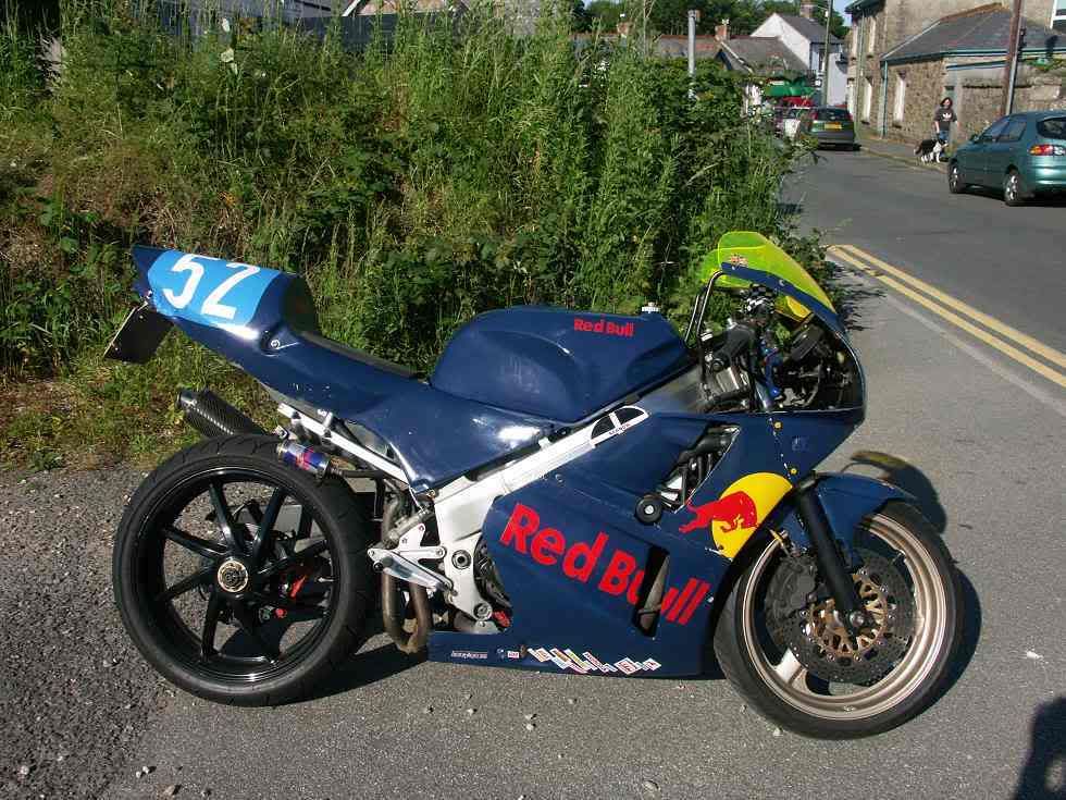

ok progress is being made
iv got an rvf front fairng lowers and rs250 tail unit now (see seat unit below)
aswells as a lightweight fairings hangar than i intend to weld onto an alloy steering stem plug, and a black tinted nc35 screen (which i will swap for a clear dp one if anyone is interested)
tyre stocks are on the up also, with a slightly scrubbed (seriously it looks like new) front pirelli wet, mre scrubbed (done one td) 090 front and a very scrubbed (recon it would last one td if i can desquare the centre a little, sides are mint, like new) 090 rear
Iv rebuildt the carbs fitted 2.5mm slides and extra 0.5mm washers on the needles and a Dual Density filter foam for Rick O also got a set of race fuel lines made up by a friend for a bit of a bargain as the originals were perished and had kinked badly, and the HRC rearsets are now on te bike along with a braided rear line and referbed the rear hub
Iv lockwired the rear sprocket, oil filer and drain plug and the filter on so the bike should be ACU legal with its race lowers
My nsr250 quick action throttle has arrived and after a while playing with siezed bolts it fitted so shud help get the power down quicker when i do get out on track
saddly iv also had my run of bad luck, being messed around for over 2 months, although did get a refund eventually on an rs250 rear shock and no refund on an nc23 front wheel so still on the look out for affordable ones of both of these
got a trackday booked at Castle Coomb on the 20th and my acu licence ctc course is on the 6th, aswell as the promise that if i can get to a trackday in may (donnington gp) Scott Smart will follow me for a session on give me some tips which i cant wait for

Looking Good mate,
I fitted an RS250 rear once before and found I had to cut away a fair bit of fairing around the reg/rec to get it to fit properly. It was either do that or fit it using spacers (which didn't quite look right)

iv had to trim the bottom a bit because it used to close back in on itself for the undertray but goes over the reg/red alright now
the only thing is iv had to trim the undertray a fair bit, had to cut the tool holder out and even now the last bit sticks out from under the seat unit but when its painted black it wont be as noticible (I hope)

ok got the rvf front end on today and i really like the look of it!
(now who can guess who i got the fairings and tail off then?)
