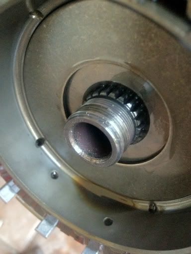

The shaft thread is well and truely stripped.
It's possible that I somehow stripped it, but I don't understand how I could have. I turned the nut the correct way the entire time, I unstaked the nut before undoing it. It just does not make sense.
The thread inside the nut is fine.
The only way I see this possibly happening is that it was stripped in the past and rattle gunned back on, or the nut was put on cross threaded and then rattle gunned on.

You could try cutting a new thread if you do not want to replace the shaft, you have nothing to loose I guess. Measure the outside diameter of the stripped thread and the pitch of the original thread. Check that you can get a nut to suit the measured diameter and pitch. If you can find a nut, then you need to find a die or a die nut the same size and pitch as the new nut and away you go. A die nut may be easier to use in the confined space. Again the shaft material might be quite hard and a die might not be able to cut a thread.

Yep that's exactly what I was thinking. It's hardened steel, tungsten steel should cut it. I would also have to Loctite the nut, which would require a butane torch to get it off next time. Shitty situation though, don't have the time, space or money for this.

I showed it to my mechanic mate, and he said it looks as though the last person to tighten the nut, over-torqued it, which damaged the thread, and over time with the force from the clutch on it, caused the threads to fail and it was stripped.
That would explain why it failed in such a short space of time and why it was slipping and not able to full engage. I also believe that theory because when the nut was on the clutch and I hadn't touched it, I could move the entire clutch basket back and forwards about a mm, which I thought was abnormal.
So in the end, I've decided I'm going to pull the engine out of the bike, bring it around to his shop, and we are going to pull the sump off, split the crank case and change the input shaft for another one.
