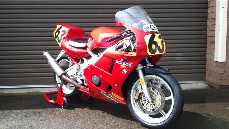

Heres a few photos of how the bike is looking at the moment.

Lovely bike! Had any time on the track with it yet?
- Posts: 7166
Re: SELEXON'S NC29 Pre Modern Racer
nicely done mate.

Looks great
I'm after a taller screen for mine, what make of screen do you have? looks taller than a normal DBubble...

Mate im not sure what the brand is, I do know its different to a MRA d'bubble screen.vr46 wrote:Looks great![]()
I will be sending the screen away to get a few spares made up. If your keen lmk and I will work out a price for a few.
