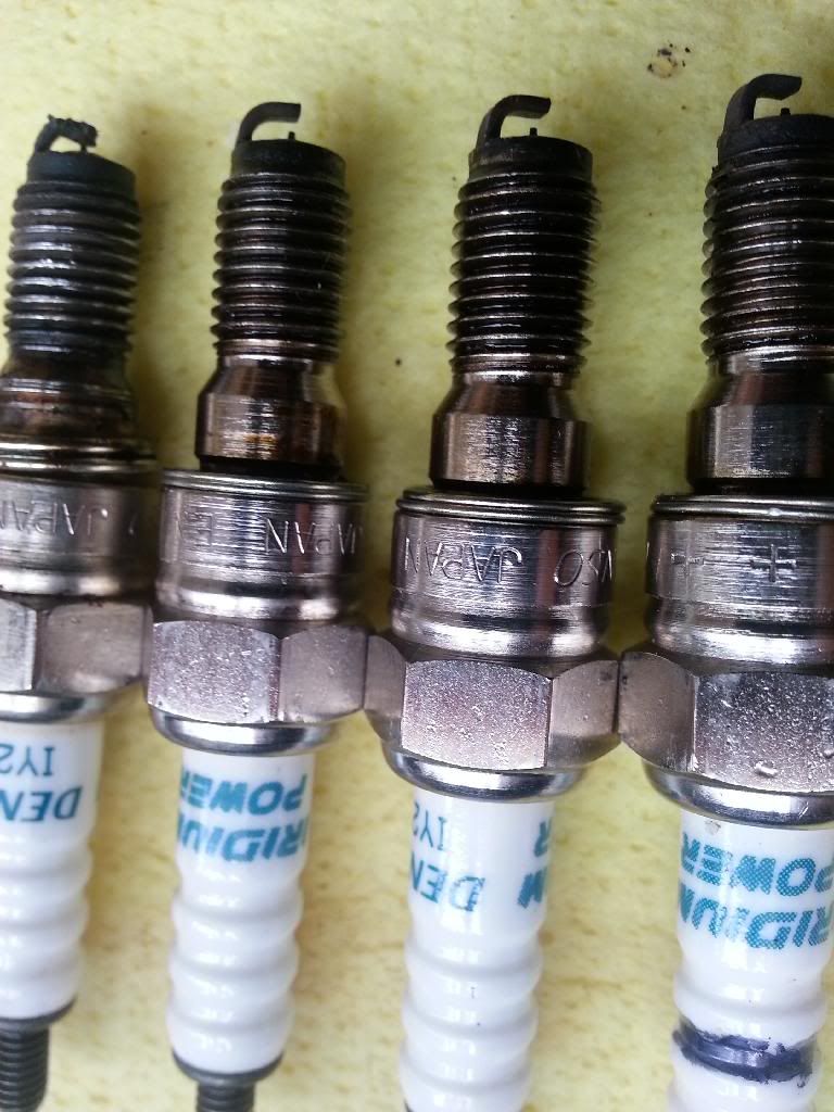

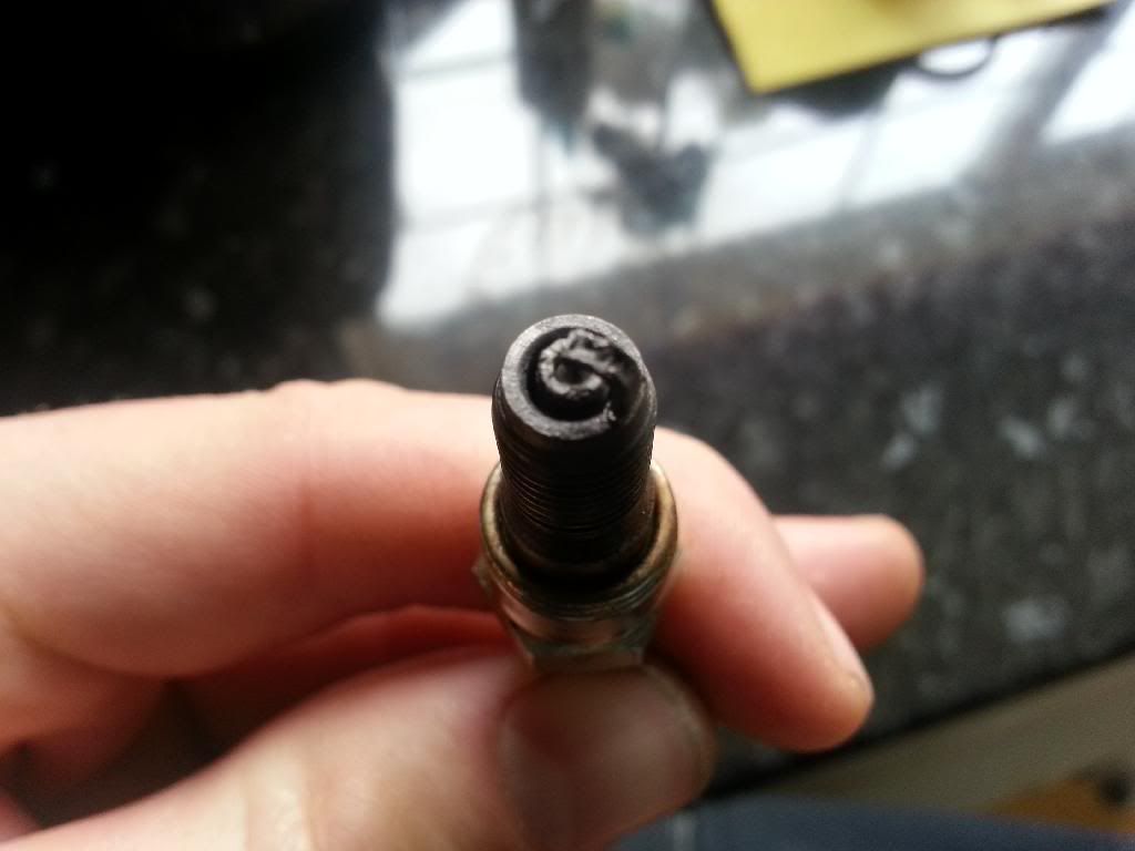

Just took all the plugs out. Spot the odd one out! Plug gap = 0.1mm.
Strangely this wasn't from the cylinder that was giving me grief.
Looks like the washer hasn't been compressed either like on all the others.
Looks to have melted. Thought it was carbon build up at first.
Plugs have done under 500 miles.

looks like u need to check/set ur mixture screws chap.could be running lean although doesnt look like tbf.

richyrd5 wrote:looks like u need to check/set ur mixture screws chap.could be running lean although doesnt look like tbf.
Yeah carbs have been off this week and serviced. I don't think it has run lean. The plugs were a light brown colour. The one which has melted was actually darker than the rest. Probably melted due to having zero plug gap DOH!!

yeh.but i doubt it was put in like that.(at least i hope not!)must be a reason its got like that.
