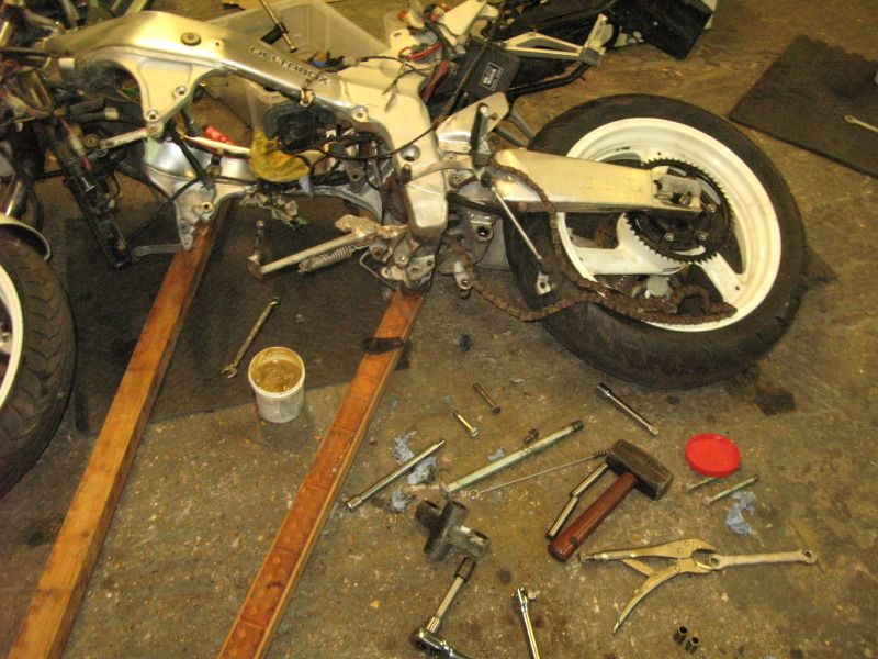

I think the loose chain is what's marked the top of the swingarm ... and why the rear braket for the chain gaurd is broken off.
So onwards then.
I undid the rear shock mounts, the linkage and the swingarm pivot nut. Then laid the bike on it's side and took it all apart, cleaned and greased all the bearings. Put it all back stood it on the side stand and torqued the nuts up, that took a while, but it's a straightforward job and well worth doing especially if the engine's out.

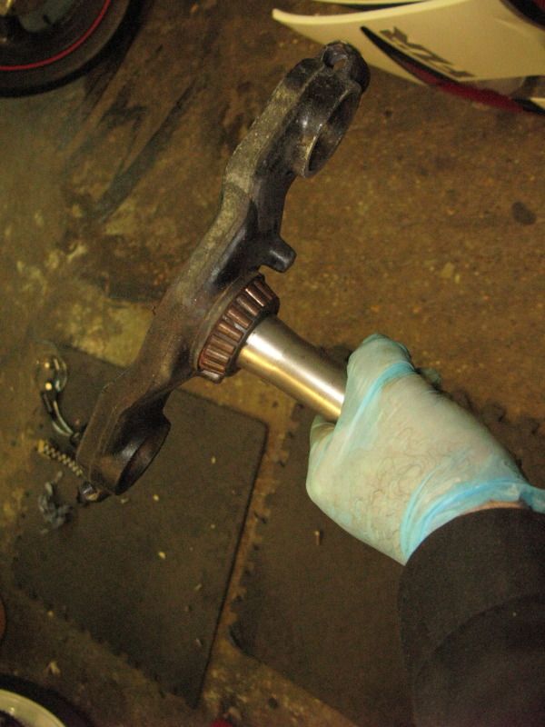

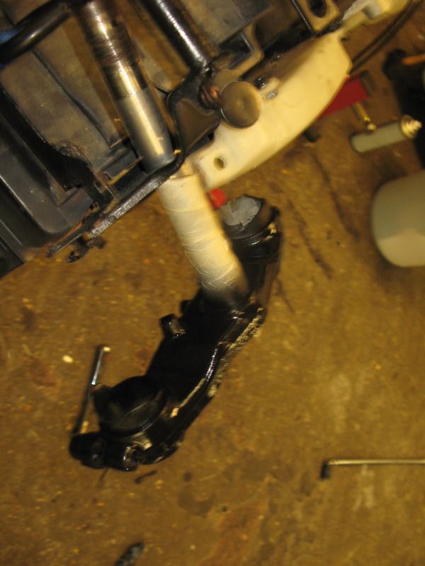

I wanderred to the other end, took the calipers off, the front wheel out, the top clamp off, and dropped the forks. I saw the castlated nuts had been undone before so I hoped the headrace bearings had been sorted, and luckily they had. Unluckily they didn't grease them when they put them in so now they're junk. For a while I though I thought I might save them and cleaned the top race with autosol, then I looked at the bottom one So I've orderred a set up.
After a bit of thwapping the lower bearing came off the stem.
I painted the bottom clamp.

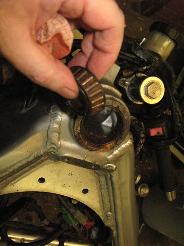

I was dreading doing the head bearings on my 3TJ.  The last set I did on a 350LC were a nigtmare to replace.  They were knackered tapers and the bearing edge was flush top & bottom.
Thank christ in the 3TJ there are two notches on the outer bearing seats for you to get a proper wallop on them

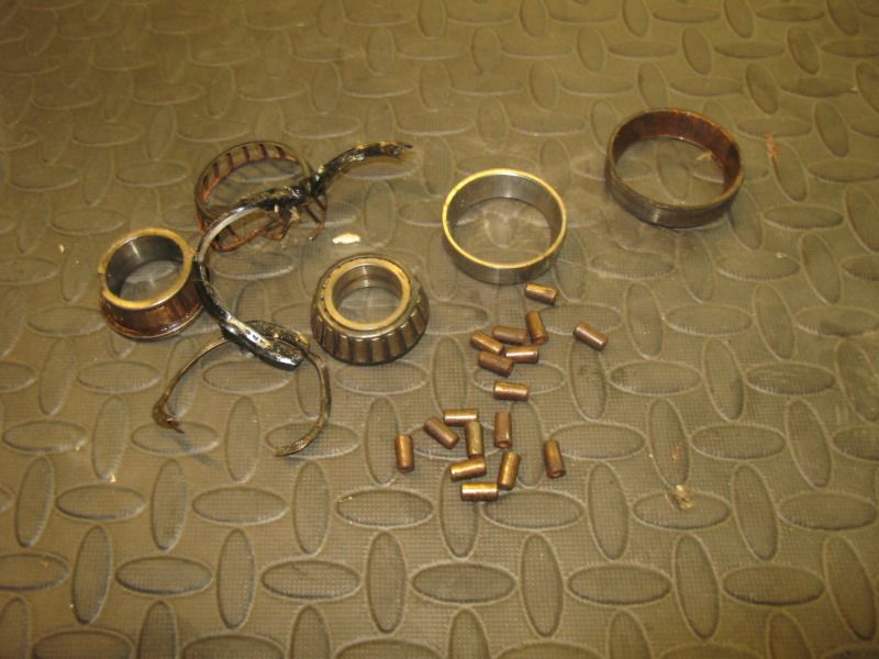

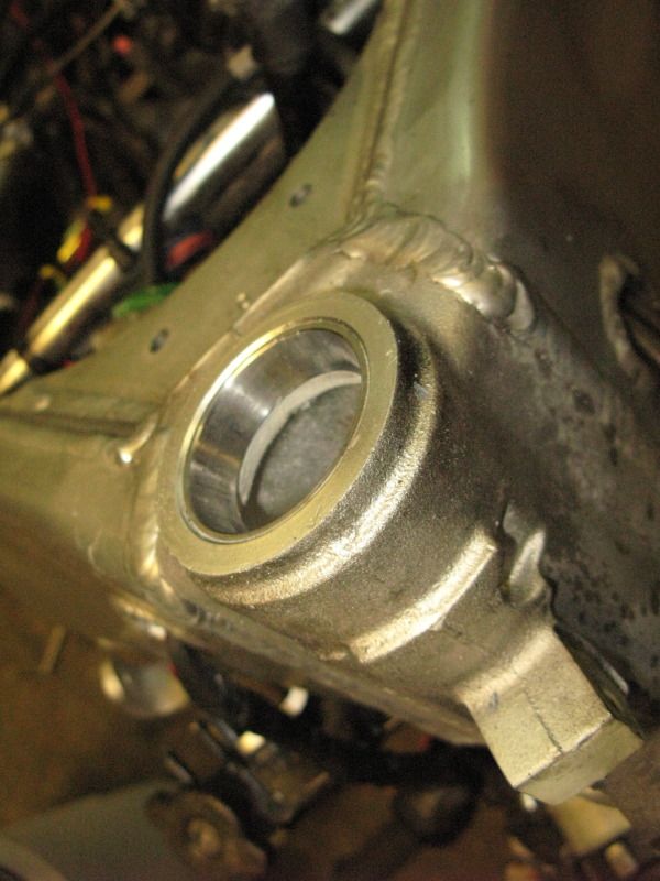

Yes knocking the races out is easy (as long as you have a drift long enough. The bottom bearing is a bit more difficult but once you've moved it off the lower clamp it's easy enoungh.

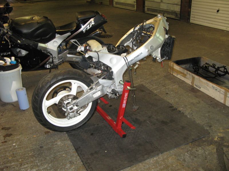

The "bike" yesterday
Bearings are orderred - I got sealed bottom one.
I'll sell this one on. there isn't enough room in my garage for 3 bikes and I don't ride the other two that often, I kinda enjoy the spannering though and I've got more confidence since the college course.

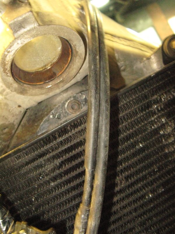

Well with not much else to do I thought I'd have a look at the tank, well tanks there are 2.
The first is a bit rusy inside, it still had petrol in there when I got the bike. The second had some sealant in there at some point but now it just looks "crispy", well I assume it's sealant.
I got some stuff that you mix with water and leave in for 12 hours, I chose to do that to number one and it's currently in the bath ... Mrs Evil is watching tv atm ... she hasn't been in the bathroom yet
Anyway I got a drill extension and some wire wheels to get as much as I could out - then I noticed a hole ... um. Anyway I had a poke about and found 2 others, they have some plumbers putty in them with pacel tape to stop the leaks.

Chemical metal is your friend.............

Got a mate saying drop a bit of weld on it but that will probably make it worse ... brazing will fuck the paint so I think you're probably right. I'll need to clean the metal back and then do a "cold repair".
Looked at the tank this morning and the inside of the cap looks cleaner, the water inside is moving around on it's own and is darker coloured so fingers crossed it's doing it's thing.
The second tank looks better structurally so if this stuff works I can clean it out inside so it might end up usable.

hope the acid bath works, always does for me,
you might find that once you empty the tank out it will get a thin layer of surface rust (more like dust really) as the acid will take it back to bare metal but is water based, so give the tank a good dry out (hair dryer is good, but don't tell her indoors)
as for the holes, liquid metal or JB weld is good (have not had good experiences with the aroldite version it's shit) but if there only tiny holes, i found the best way was to take a punch and make a small dent around the hole(4/5mm) then score the indentation with the blade of a stanley, this gives the glue something the adhere too and makes rubbing back easier for an invisible finnish
if it's gonna be stood for a while you can stop the rust in the tank by putting 1/2 pt of 2T mix in, give it a shake then drain out, this will put a thin layer of oil on the inside of the tank, but only in the short term as the oil will dry out over the months and varnish the tank, sender and tap, meaning you gotta clean it again
