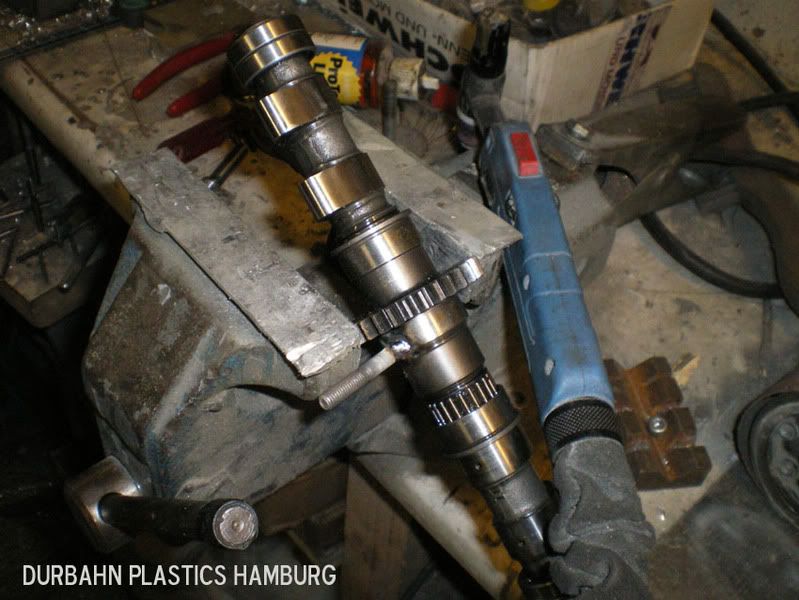

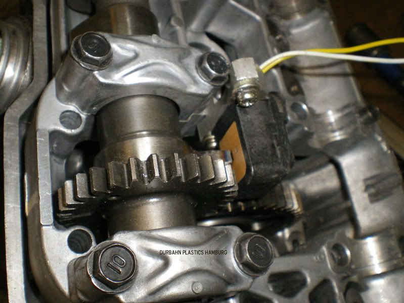

Camshaft position sensor
Thanks guys from Durbahn and fourfingers (who direct me to this link) http://www.durbahn.de/RC30Sensors.htm They made camshaft position sensor directly to camshat, not made additions trigger wheel on the end of the intake camshaft like I was plannig before. They ever used crank position sensor and used it as donor. For now this is most good idea - problem only to fabricate bracket to fit sensor.
So, enjoy link and picture...
Re: CBR400RR NC29: Fuel injection based in Microsquirt EFI.
Yeh that looks like a better option, although welding something onto a camshaft is not something I'd like to try!
Any hall effect sensor can be used, looks like durbahn also made a custom mount for the sensor but hard to tell in the pic.
