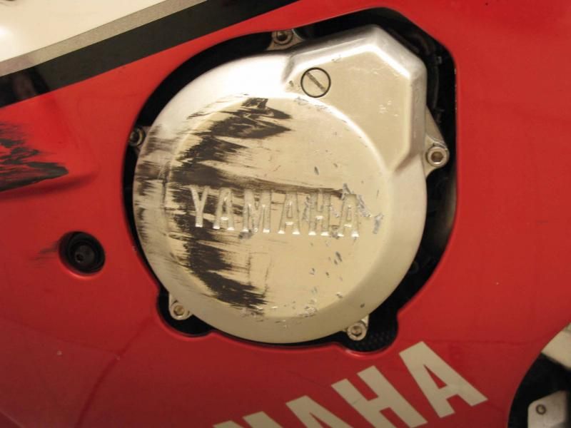

So I've been riding the bike a bit and found a bit of oil on my left boot. I had a bit of a look about and see oil on the engine, which isn't good, following the oil points to the can cover. Well it could be a lot worse. Like most skilled mechanicalists I just tightened the bolts down a bit more ... I'm surprised that didn't work.
Originally I used a gasket kit from eBay and noticed I had a bit of a problem with the gasket fitting that and cover itself was a bit corroded. I had a look about and found a genuine gasket going a bit cheap, got that, so yesterday i started the job.
Saddle, tank, airbox and fairing off is fairly quick. The plug caps were a bit fiddley and the cover bolts werent to difficult with flex head ratchet spanner to the rescue. There was still no way the cover would come out though so I undid the rad, still no, so undid the bottom hose and dumped the coolant. That did it.
With the cover off I cleaned up the gaskets mating groove with a copper brush and then wet n dry. Ive used a heat resistant sillicon and bonded the gasket in, then lft it to dry out overnight.

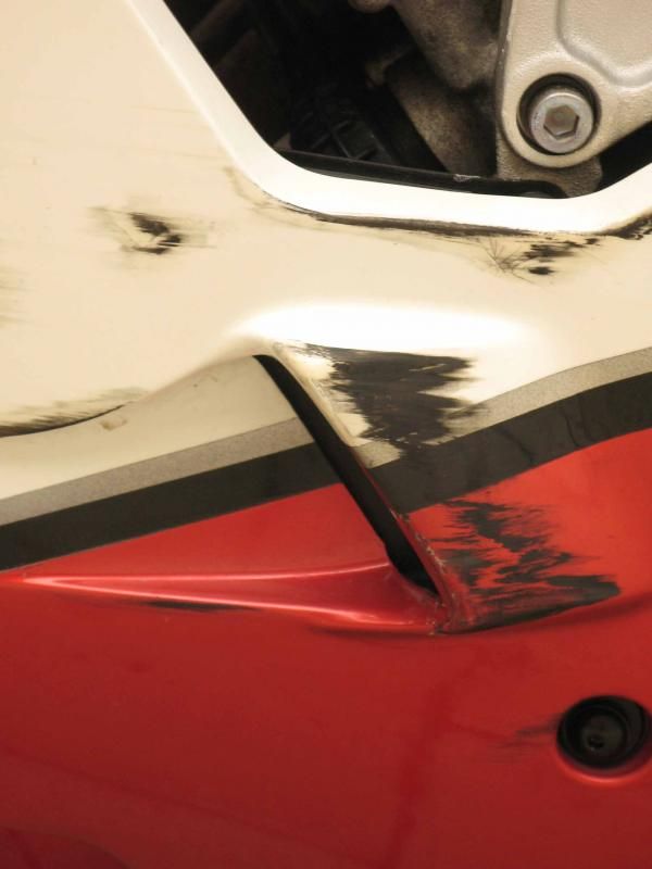

Just in time for a dickhead to make a U turn on Waterloo Bridge. I dropped the bike on the left, there wasn't a great deal of damage but enough of the unobtainable bits and a small dent in the tank to write it off

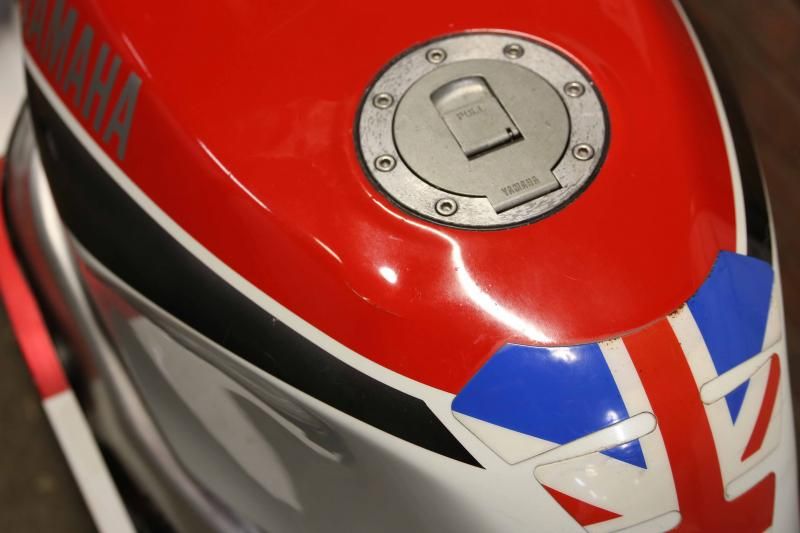

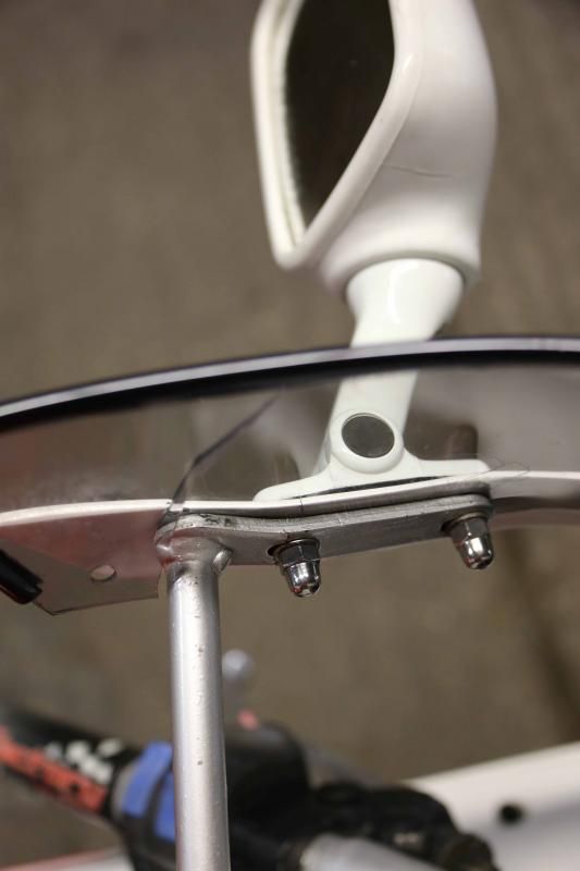

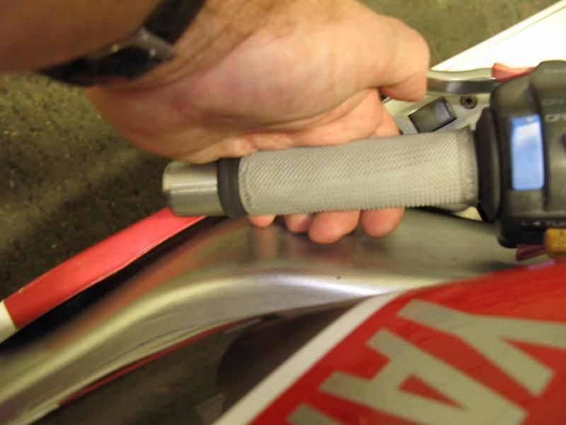

The guy was saying to the insurance company solicitors that I had hit the brakes and dropped the bike because of that. Well first off I used those goldfenn (?) pads and doubt those and standard brakes could lock the front on a dry road, second is the the amount of rubber on the fairing from his tyre

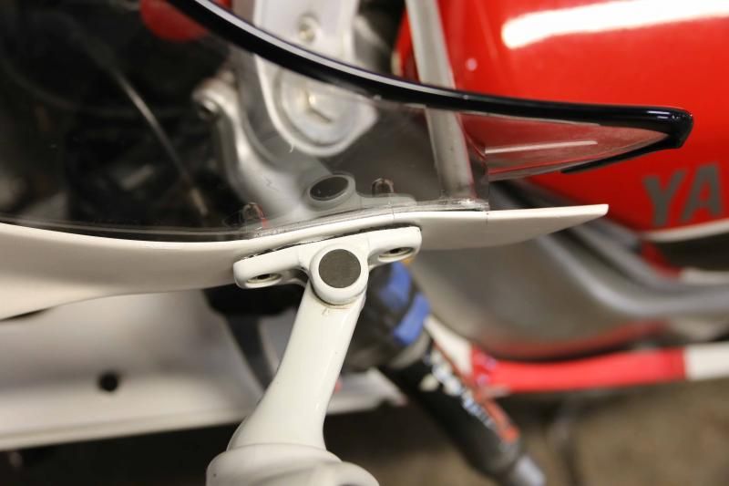

it scuffed up the mirror which is annoying because they're white and hard to find in decent condition. Broke the screen, bent the mirror brace and of course cracked the top fairing
Bent the bar, and the dent to the tank

Them mirrors are not half as hard to find as the Genesis/2Tk one Laminator is still looking for.
Bastard about the screen brace; they seem a hen's teeth job.... mind I did link up a brand new one on the forum that was very cheap a few months ago.

The bike was valued by the insurance at £1250, that was the first offer but I didn't contest it. My excess was £50 and I bought the bike back for £400 so I got £800 payment.
It was Cat D write off - I've bought a screen from Skidmarx
Got a mirror brace from Taggy
I'll need to get the plastex out, clean the bodywork and repray the genny cover.
The tank will be a bit tricky
The bar and clutch I can take off my black bike ... that will get a few more bits on it
