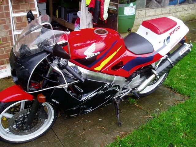

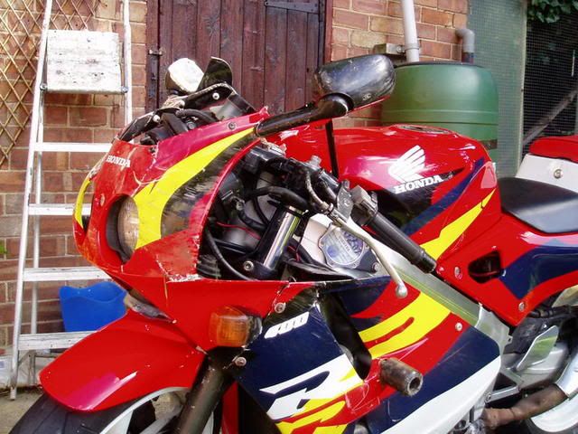

I did post up a thread waaaay back on the old forum about my rebuild of a set of Crash damaged Panels using Plastech (as was) Plastex now I believe. I cannot find the link to the original thread but still have some of the photos in my photobucket stash…
My pride and joy…as was
And following an unplanned shortcut through a Lincolnshire hedge…

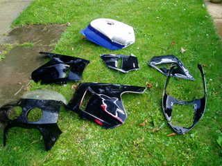

My panels were after-market anyway and FUBAR after the off so I managed to get a set of (also crash damaged) OEM fairings off another forum member on here (anyone remember Billy Bilboa?)
Some of these just need a lot of rubbing down and some filler where they had tarmac grazes..
But a lot of the fairings were earth cracked or even had bits missing…

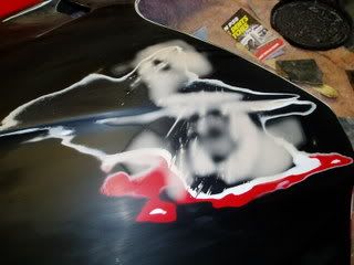

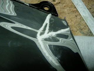

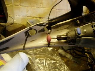

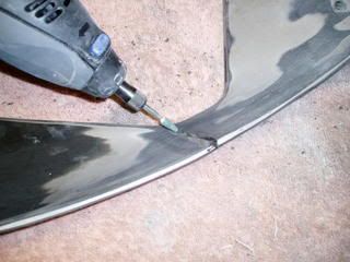

Having heard good things about Plastech I bought a bottle and set to work. Now the secret here (or so I found) was to give the stuff enough surface area to work with. By this if you have a crack you are trying to fix you cut/grind the crack into a ‘V’ groove (as per the instructions) so there is more surface area for the plastech to bond with – which it does very well. NB – a Dremmel is a top tool for this…
Holes for things like the mirror stays can just be filled in for ease of application and then carefully re-drilled afterwards..

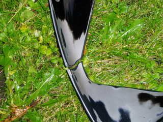

Even a jigsaw of broken (or even missing) bits of plastic can be rebuilt with some patience.
Once you have ‘cast’ the new Plastic you just rub it back down and final shape it with sand paper / Wet and dry and with some patience you can really get back to the original shape of the OEM panel. Things like the lugs etc on the inside that often broken or missing can also be rebuilt providing you with a full set of resurrected OEM panels…

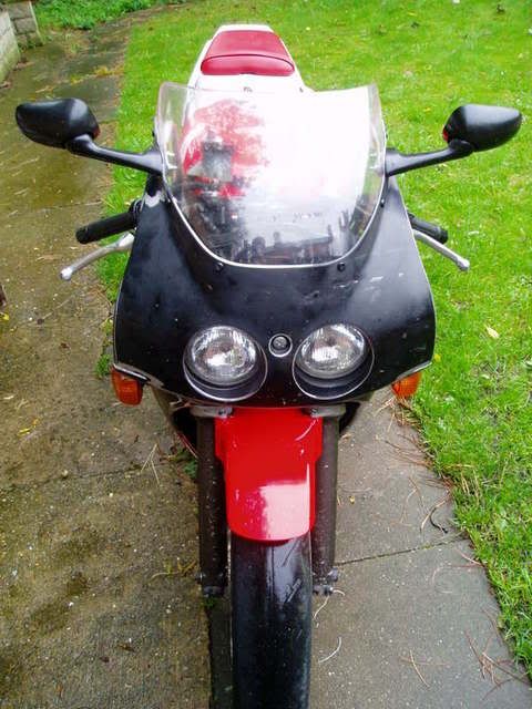

Once rebuilt and extensivley road tested to see how they would hold up to the real world, I was seriously impressed with how good these repairs were…and in due course these very same ‘repaired’ panels got some paint lovin’ and became No1..which are still going strong today, several years later
So if the current stuff is anything like the stuff back then, then 'Yes' you can get a very good quality fix for your broken plastics, but you will probably need to plan on respraying the panels afterwards if you are going to do a 'proper job' as you really do need to cut in, sand down etc
