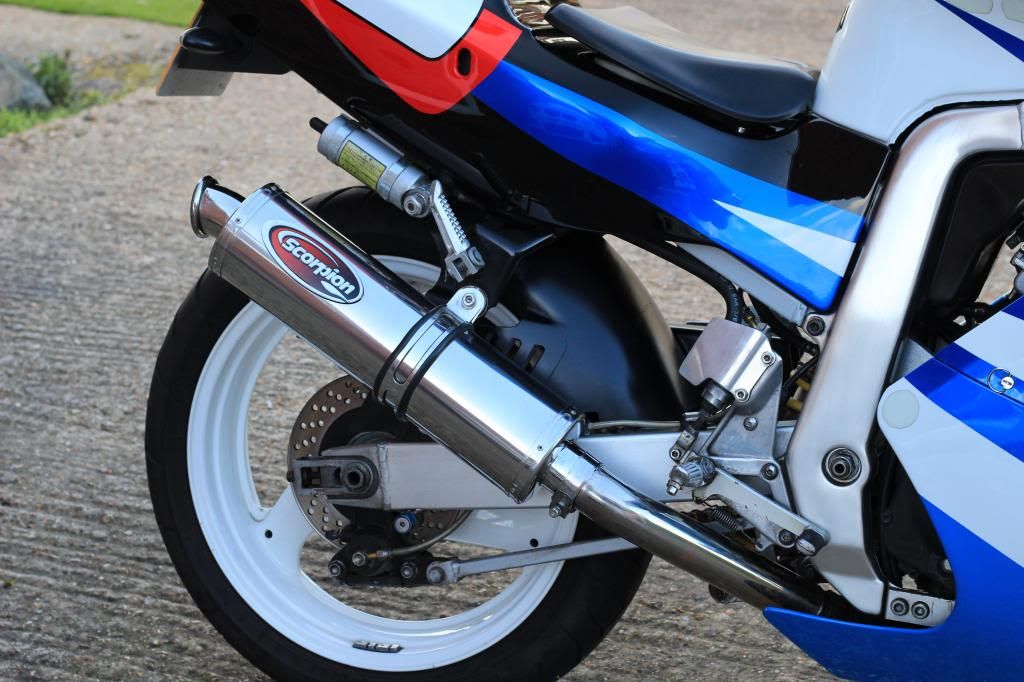

I've now fitted the scorpion exhaust but it doesnt sound like its running as well as it was before. I've let it warm up a fair bit but when I give it some throttle in neutral it seems a bit boggy. The exhaust isnt blowing from anywhere either. Does this mean I'm going to have to rolling road it to get the right fuel/air mixture. The bike was running as sweet as a nut before.

I took the bike out for a ride earlier and it seemed fine. I think the slight boggyness might of been where the bike hasnt been ran for a few weeks and there may of been some stinkin petrol in the carvs or something. Although I already had a blue flame end can on there before i put the scorpion on i can definitely hear the difference, and i may be imagining it but the bikes response seems a bit smoother.

Re: GK76a Exhaust
Yes mate the can was in really good nick. I'll upload some pics later if I get a chance. I've got a small clip of the noise it produces as well which you can view using the link below:

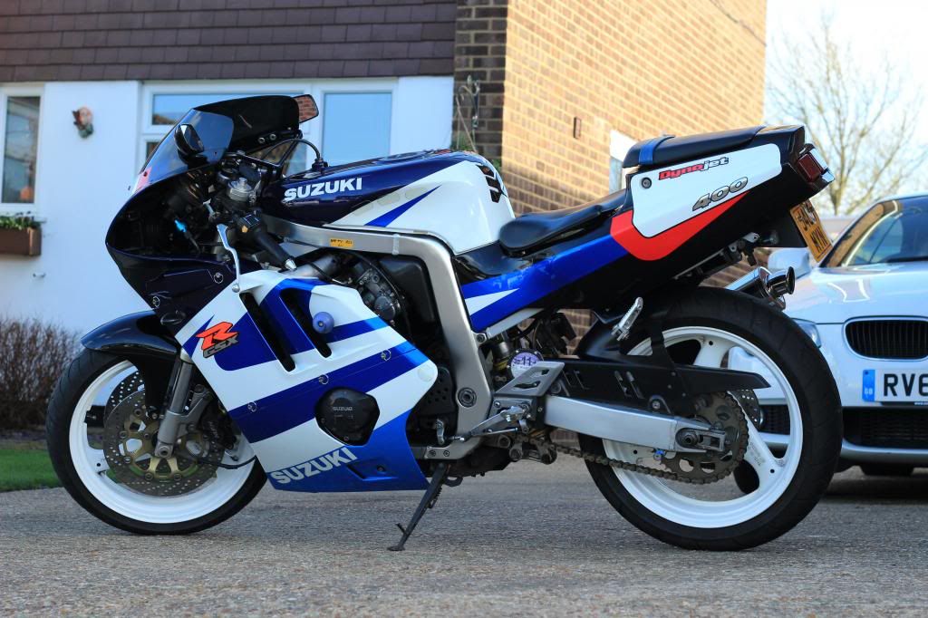

- Posts: 21
- Joined: Wed Dec 12, 2012 1:23 pm
- Bike owned: GSXR400SP GK76a
- Location: Reading
Re: GK76a Exhaust
Thought I might as well go the whole way and get pretty much every angle!

Re: GK76a Exhaust
Looks really nice mate I like it and it sounds good. How are you getting on with those header pipes do you think they are worth it ? I wanted a set but I keep stoping myself because of the recent comments about them
