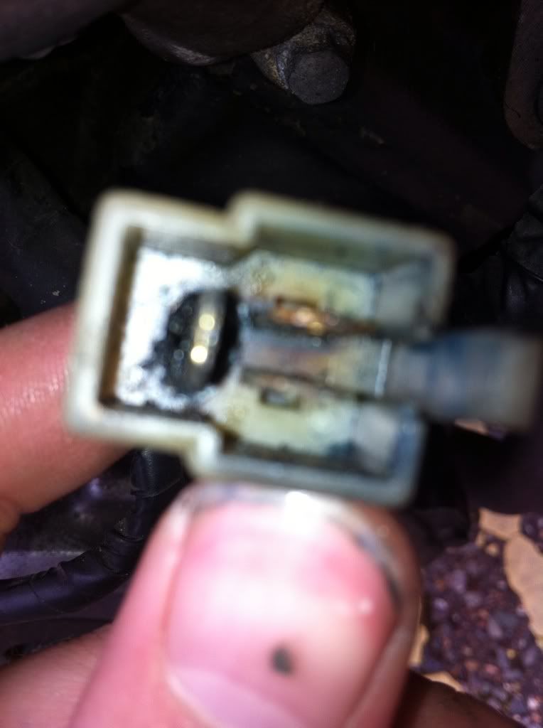

im pretty sure the alternator is now going to be fubared
heres the connections actually to the stator
i also couldnt test the voltage across them cause the bike wont even bump start now ... and the battery is reading 7 volts
ive got battery on charge and im hoping it will just start the bike once so i can test the stator

You need to fix all the bad connectors, the alternator is probably ok because you have already measured 40 Volt AC between the three yellow wires. Once the wiring/connectors are all fixed, reconnect the rect/reg and check to see if the battery is being charged. There maybe nothing wrong with the rect/reg, just the bad wiring/connectors. You do not need to start the bike to do the alternator AC test again.
Your battery is probably stuffed, it should never be allowed to go below 10 volts. After charging it you may be able to bump start your bike but I doubt it will run the starter motor. Also remember, any charging system tests done with a bad battery can give misleading results. The rect/reg needs a reliable stable battery voltage to function correctly.

exactly as magg says..
my connector block was exactly the same. just cut all the wires and replace the connector block. SOLDER all the connections properly and you should be good to go..
once the connector block is replaced and the connections to the reg/rec are sorted out, you should be able to get it running and then diagnose whether you need new battery or reg.. possibly both..
