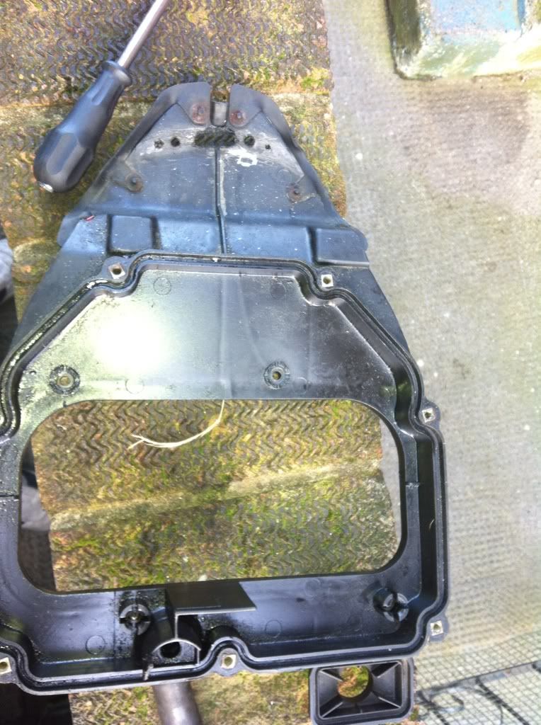

heres my snorkel (holes are bigger than i remember but cant remedy that)

by the looks of things i have a bit missing-i dont think thats the "snorkel" correct me if im wrong

theres a flap missing aswell
i have the carb tray (as above) and nothing else my air box just has a hole in the front with nothing attatched but in a thread i found
which i dont have
i could kick this fecking bike at times
which i dont have

When I bought my bike in stock trim, I didn't have a snorkel either, but it ran fine. You NEED to open up the carbs and check the jetting! This should be no.1 on the list. The previous owner has obvious modified the carbs (hence the cut down stacks) and until you know the state of play with the jetting, it is hard to give any kind of advice.leerc wrote:theres a flap missing aswell

Yes thats the one, you need that.leerc wrote:do you mean this flap
http://www.400greybike.cc/forum/viewtop ... 24&t=25608
as im pretty confident my snorkel doesnt look like that
The jetting you have is for a half or full system so its acceptable but you need to sort the intake side of things, get a snorkle, clamps and stock rubber stacks. I think i have all the above, if you need them let me know.
