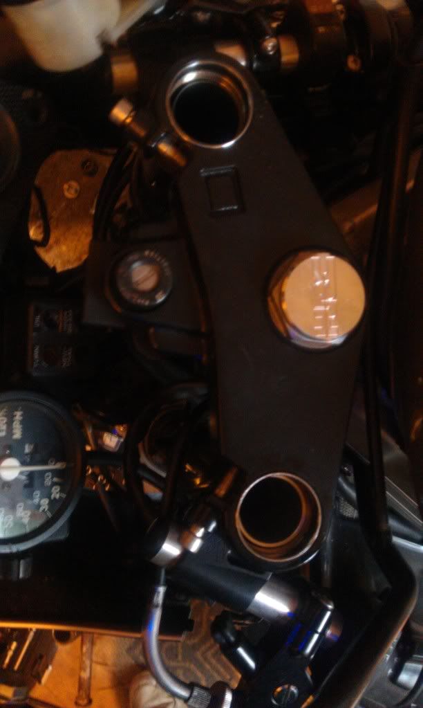

Hadies
Posts: 606
Re: My Seed 30
Post by Hadies »
its a 5min job hade,
suspend the front end,
undo the fork adjuster caps
pull the old springs and spacers out, put new ones in simples.
drain the old oil first with the 10mm hex head bolt at the back of the forks,
It really as simple as that^^^
Loosen top yoke clamp bolts and undo fork tops;
Drain oil;
Pull out spacer, washer and old spring and replace with new ones;
Fit drain bolt and fill with 450ml of fork oil.
Slide the stanchion into the fork bottom and remove the excess oil with the supplied syringe.
JOB DONE!
