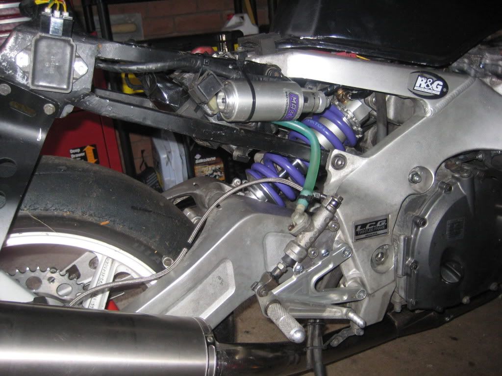

Anyone???VForcer wrote:
Also found that the small diameter pipe coming from the fuel pump is the drain hose (does this hose just route down and exit as an open pipe at the bottom?)
Rob

I think it does, through a bracket near your right foot.

You can see just behind the rearset the pipes and bracket.

That's fab Chris, really appreciate you taking the time to post the pics up
