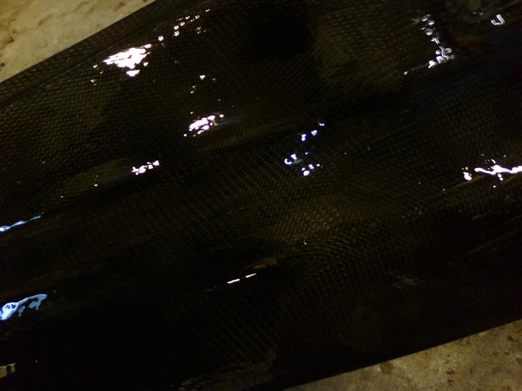

just given the tailpod a 2nd coat of epoxy so i got something to cut inco while polishing !!
its a terrible shot i know . . . mobile's to blame!! it is under there i promise

oh right . . . you didn't fit it yourself ?? ive seen them for sale elsewhere too but just wondered how you get them on ?? i suppose its just alot of bending and kicking . . .
yeah tailpod is original plastic with a carbon fiber 'skin' . . . skinning is a fairly simple procedure as there are no moulds or jigs to make !! the downside is your not actually saving any weight and your panels get used up in the process.
for me it was a choice of a new paint job, new fairings or diy carbon fiber !! i hate painting unless im geting paid for it . . . new fairings are out of the question due to cost . . . so i was left with one option he he
