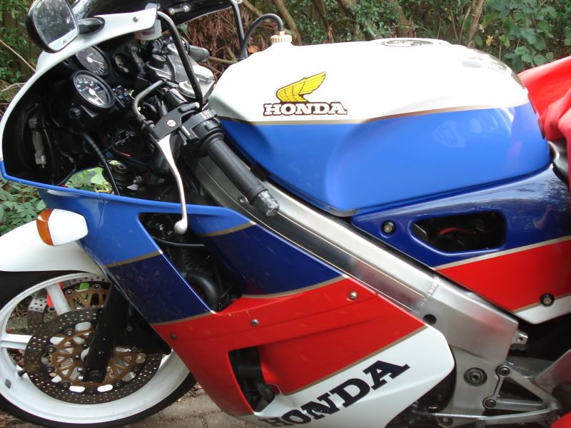

Taken a few pics of the the tank. Obviously the holes are under the grey putty there is two tiny pin prick hole and one slightly larger but still quite small. They are along the seam of the where it bends.

I would not weld the tank if you wish to keep the paintwork good,
I would use a tankseal on the inside,you could then remove the putty from the outside,
a touch of paint job done.

To be honest ive resigned myself to the fact ive got to do all the paintwork again at some point soon, so the tank will be done again anyway. I may go for the standard RWB scheme or re-do the rc30 scheme. Some opinions on this would be good!!

If you want to do that then look at the inside of the tank
top and bottom because it will only be a matter of time before the next one will appear http://www.therustshop.com/" onclick="window.open(this.href);return false; do a great kit from KBS Coatings and its really good and easy as pie to use
and don't be shocked at wat you see
