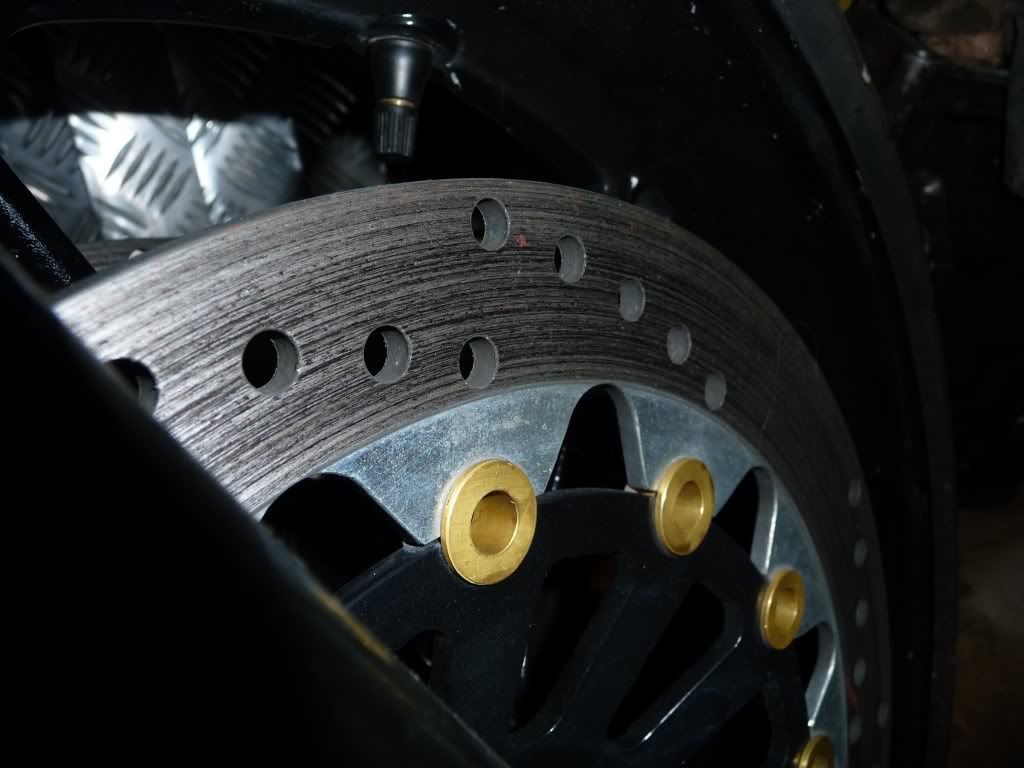

Anyway as the title suggests is anyone here using these discs. I have the Carward race eng adaptors, Fireblade calipers and m/c and OE Honda sintered pads. However i've never been happy with the discs stealth 310mm rotors on NC30 carriers. Does anyone else here have this same set up? The metal from the discs seems to pick up on the pads giving a very grabby feel which you feel a lot more at low speeds with lots of judder. The discs are ok for runout, the calipers aren't sticking and the headrace bearings (tapered) are all ok. (no problem with original calipers / discs etc). I tried brembo and EBC pads all to the same effect. I'm convinced the problem is the material that the discs are made from..

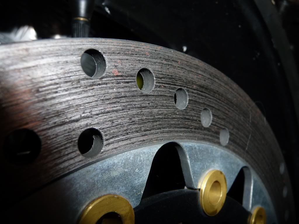

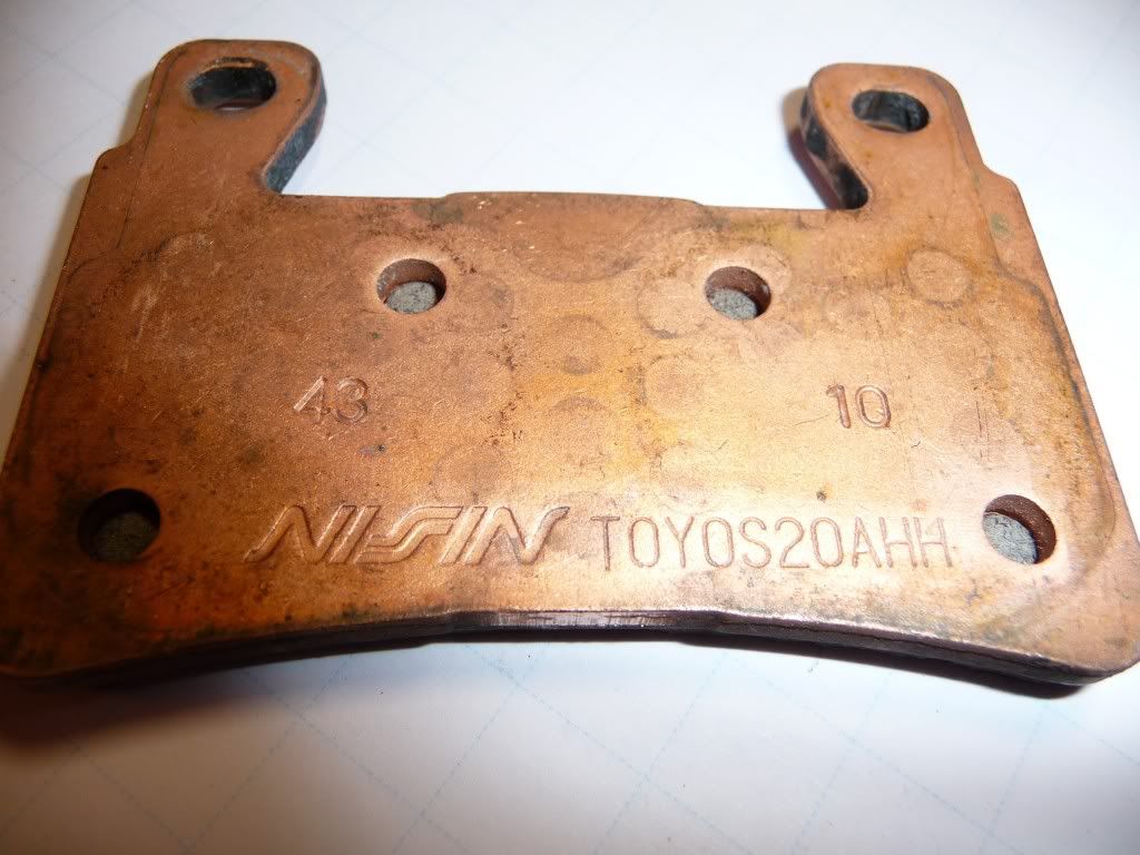

Attached should be two photos of the discs and also the pads i've been using, OE Nissin HH compound. If you look closely at the disc i think there is some 'Galling' going on. There are also some deep scores in both the discs and the pads. And even if they don't look so bad to some of you they don't feel good at all.
Posts: 7166
Re: Stealth 310mm front discs
Post by CMSMJ1 »
Doesn't look to good that... Mine are nothing like that - lots of iron in mine as they'll rust up over a weekend. I almost bought some pads for racing that had a specific compound for stainless/non ferrous steels. I took them back and swapped for EBC HH and they are fine.
I have also used the Nissin pads and found them great.
Might be that your rotor is different steel to mine.
I'd get in touch with Stealth and ask them. End of the day they want to be known to sell a quality product adn I would expect they will look into it for you.

my discs are looking like that , my workshop buddy said dodgy wheel bearings could possibly be the cause so i replaced them now, will see if the discs start to smooth over, also he noticed me spacers wernt in very good condition and said i should get that sorted too , but he tends to think its all related to the dark scoring on the discs , very interesting subject this as its bugging me at the mo too

Well maybe but my wheel bearings are OK, nice and smooth and runout all within spec on the wheels/discs and also new spacers when i fitted the discs. My conclusion is that they are made out of the wrong grade of steel. (They were fine with the old calipers and NC30 discs). As i haven't heard anything from Stealth i can only assume they are a not at all bothered about the safety of the people they are supplying thier products to, or they know full well with some of thier discs there could be a problem and just don't want to admit it. I don't know why as many people seem to be happy with them... As it's been a while since i purchased them all i wanted was to know what was the problem is..I'd have even bought another set... Anyway i've seen Mr Oliver sells adapters for my firebalde calipers and EBC discs so i'll proabably be going for a set of them next. Are you running the same calipers and and spacers for the Carward/Stealth 310mm kit?
