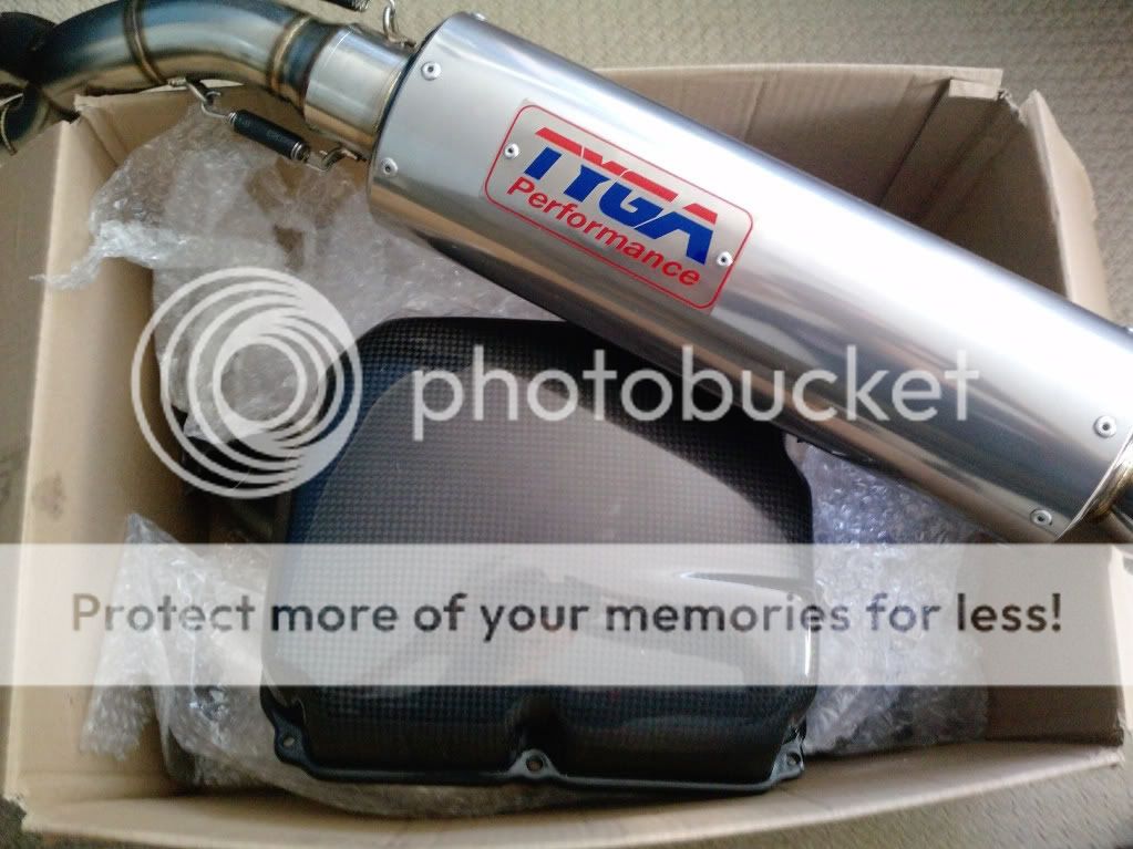

Yet, it does put a smile on my face when i see packages like this turn up at my door...
