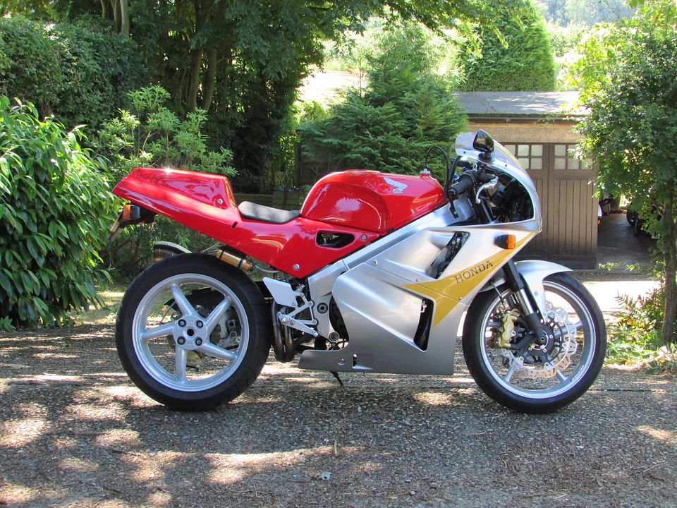

To give this some context, I`m just old enough to have seen the RC172 and RC181 raced in anger rather than simply paraded and those experiences plant something in the head of a bike mad 14 year old that just can`t be shifted.
This is my `best` NC30 (a 1989 RK model which I`ve owned since 1992) and I`ve had something in that colour scheme, from CB77s through 400/4s to NC30s, in my garage for most of my biking life.

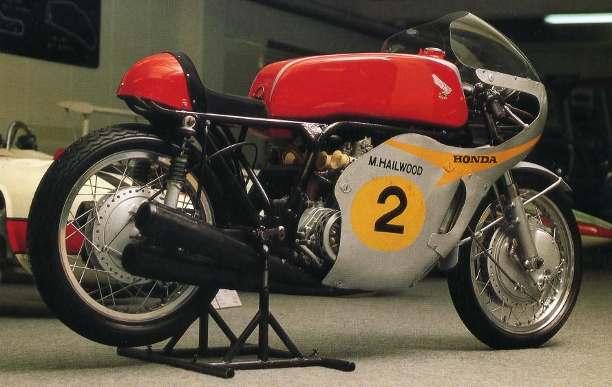

The original plan for this current build was a full on RC181 tribute (obviously a V4 with a beam frame is never going to be a replica) -
- wearing full fairing with twin oil coolers in the flanks, spoked wheels with alloy rims and a four megaphone exhaust system. I`ve got most of the necessary parts and it may well end up there but for the moment this is a basic proof of concept build to see if the chassis configuration actually works.

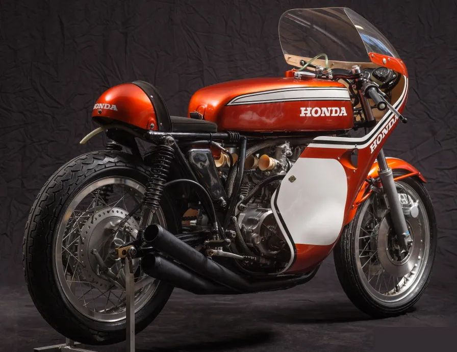

Foxy - you`re right, the seat hump is a tad taller than the one on the 60s GP bikes - it`s actually a replica of the seat used on the CR750s that Honda built for Daytona in 1970, the closest thing that`s commercially available at a reasonable price.
It looks better in the flesh than that photo suggests - I`ll post some more pics when I have a bit more of it bolted together.

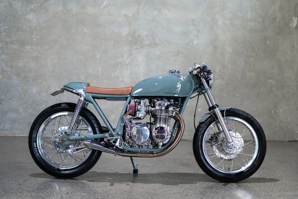

The whole chunky look is a kick back against the 21st century concept of what constitutes a Cafe Racer - to my eye this kind of thing (with due apologies to whoever built it) -
- is just a stripped out stock bike with an uncomfortable seat and inadequate mudguards...

The term 'cafe racer' is bandied about a lot nowadays and used on a whole range of bikes, many of which would never have passed for CR's back in their heyday of the '50's & 60's. So I know what you mean about that Honda, it's got elements but isn't quite there.
