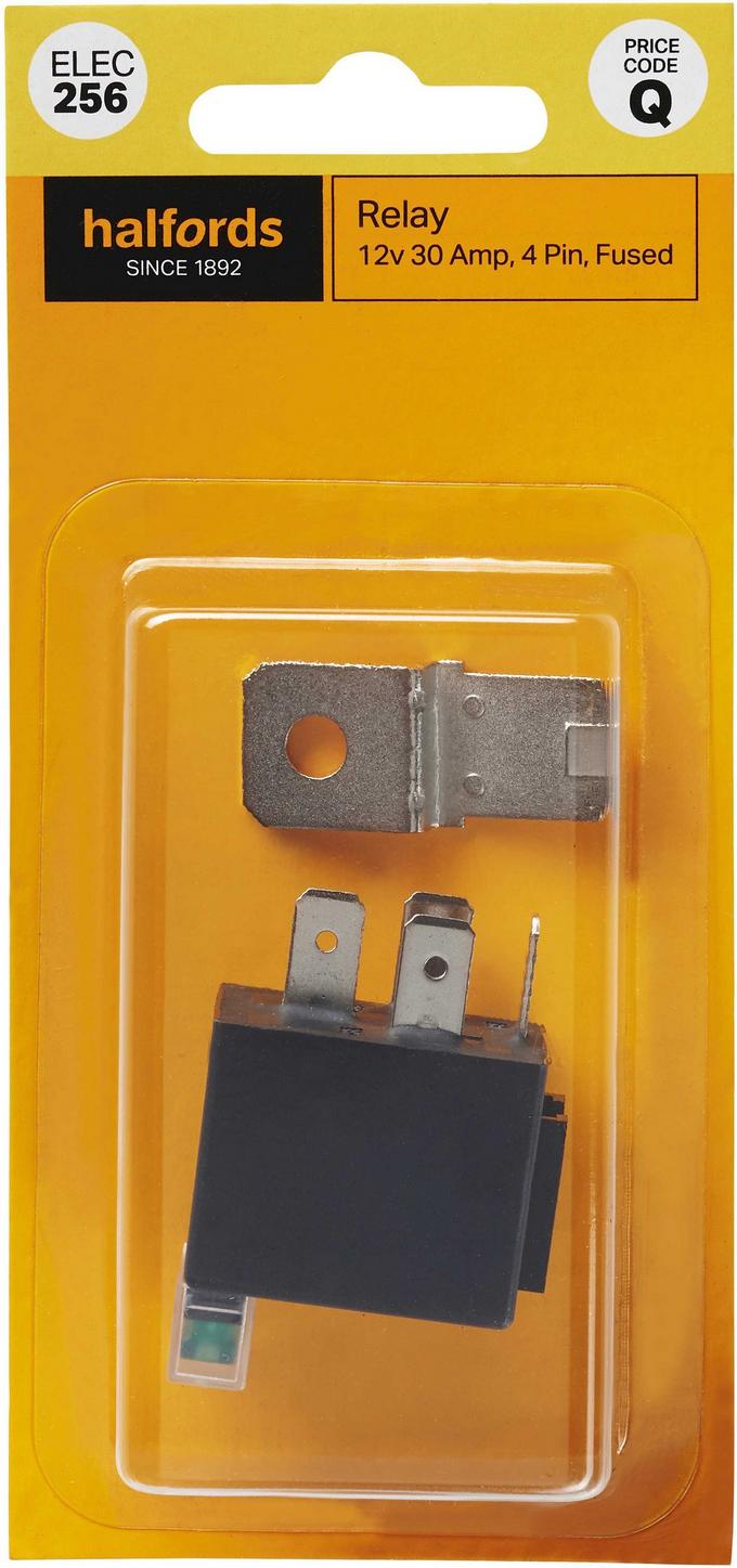

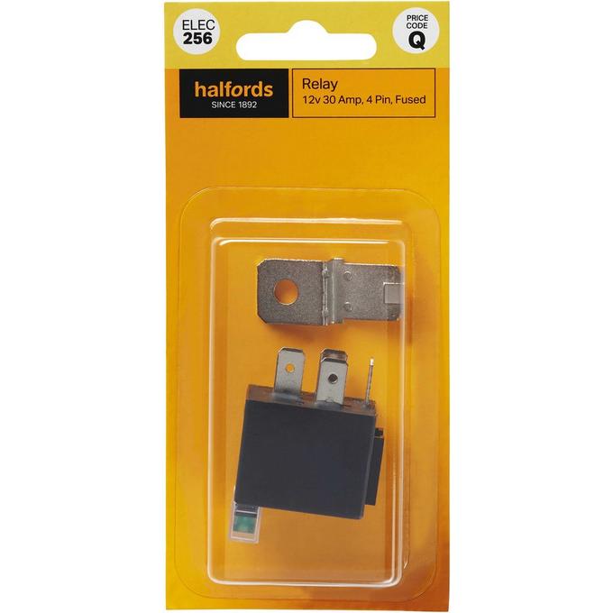

One of these
It is usually fitted somewhere near the headlamp as you use the original 12v wire to operate the relay coil.
