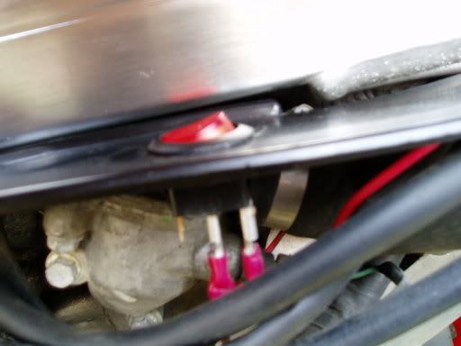

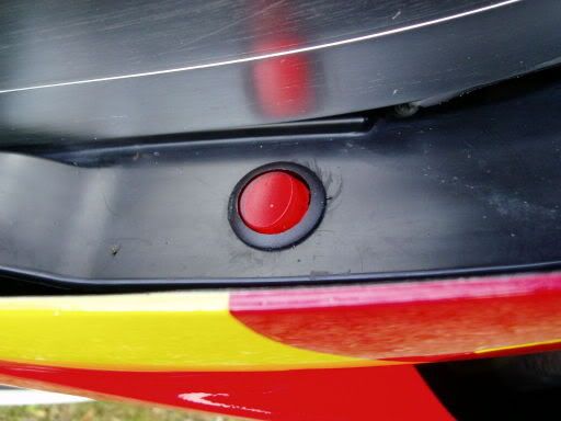

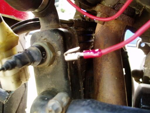

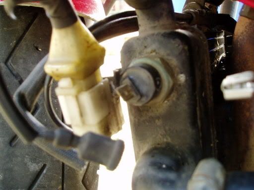

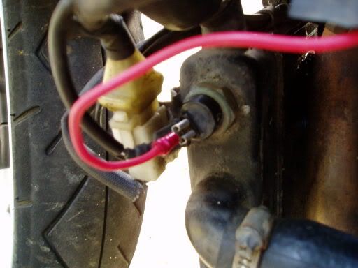

I did this 'fan bypass' set up on one of my bikes ages ago as it was getting very warm when driving through town. In hindsight a good clean of the rads would have probobly done just as well (it was pre-chinese rads being available) but with a new chinese lower on my current bike, it is very rare the bike even gets hot enough to trigger the fan anymore.
Anyway as per Neo's comments above if you still want to do it:
Get yourself a switch of some sort and locate on the bike (I fitted mine into the R/H infil panel).
From the back of the switch there will be two terminals.
Run a cable from one of these terminals to earth. From the other terminal run another piece of cable down to the temp sensor on the L/H side of the lower radiator and fit with a piggy back connector.
Remove the spade conector that goes onto the temp sensor..
Connect original temp sensor spade to the new wire using the piggy back connector, then connect both wires to the temp sensor - Job done.
If you know you are heading into town or such like you can manualy turn the switch on and the fan will run. If you dont have the switch on but the temp gets hot enough the fan will still work automaticaly as designed to do.
