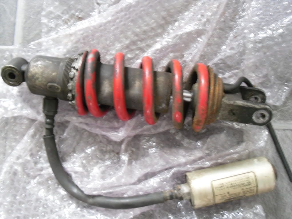

look up nc24 shocks on ebay for some pictures.drwilliam46 wrote:How would I know if it's a nc24Neosophist wrote:it looks like you have an nc24 rear shock on it though and not an nc30 shock...drwilliam46 wrote:Got the swing arm and rims free from a scrap yard here by me, that dog bone is giving me issues to find.
cant make it out in the pictures but they are not the same
nc24 shock looks like this, biggest give-away is the black remote adjuster.
If this was on the swingarm it could be an nc24 swingarm but they have different hubs.. interesting maybe you bought it after if you have an nc24 shock
NC30 shocks come in two types.. the early and later type.. the early one is vastly inferoror compared to the later.
89 earyl shock, this is rubbish
nc30 later rear shock.. much better

Ok mine is definitely a nc24 shock. Am I going to be able to use it? Is the size smaller than Nc30?

different size to nc30 length wise i believe.drwilliam46 wrote:Ok mine is definitely a nc24 shock. Am I going to be able to use it? Is the size smaller than Nc30?
