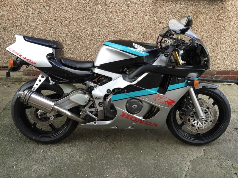

Ok, seeing as I posted this on my introduction thread...

Very nice, so what have you decided to do suspension wise? Emulators up front and a cbr600 fully adjustable at the back? Or you could go for late nc30 forks (the adjustable ones) and just put your fork lowes on to keep it looking standard ? Tyga do some really sweet cnc'd rearsets with carbon heel guards! And you'll need an ignitech ignition with HRC map for a bit more go! 8-)
http://tyga-performance.com/site/produc ... ts_id=3518

Aftermarket cbr600 Shock with height adjustment and emulators in the front I think. I'm hopefully going to the NEC show in a couple of weeks, so I'll have a better idea after that.
As for rearsets, I remembered over the weekend that I've actually got some HRC ones for a cbr600rr sat in a box, so I'll offer those up and see what's what.
And the Ignitech ignition, sounds good, tell me more :D
