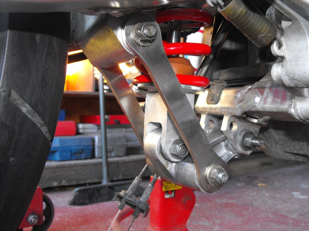

Read up on front fork upgrades for these.
Wirth springs versus stock 3EN2
15 w oil works well opposed to 10w.
Start searching for an 2006/7 R6 shock and Kayla does the matching 138mm dogbones.
