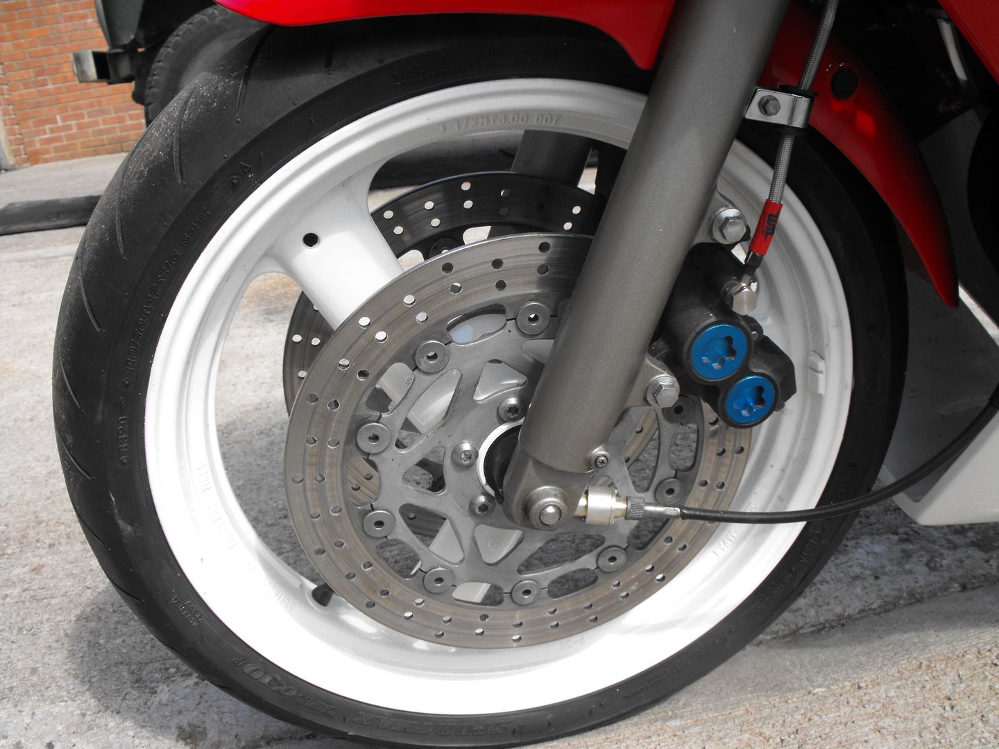

Why not fit some Blue Spots from an R6 ... the gold spots are slightly better, both will bolt onto your forks

By the time you buy the seal kit...and most have found that the pattern kits sold only fit one of the two pistons..... so buy genuine seals separately....2 from a fzr 1000 and 2 from (can't recall) which is very costly
it is much cheaper to upgrade to "spot calipers".

I also have a set of blue spots sitting in the garage (was going to put them on my XS1), they bolt straight onto the 3en2 forks??

NON radial spot calipers are not only bolt on but economical.
The next upgrade is the braided lines and the matching master cyl. that uses an adjustable span lever.. (Fazer, T/cat/ace are compatible AND cheap)
