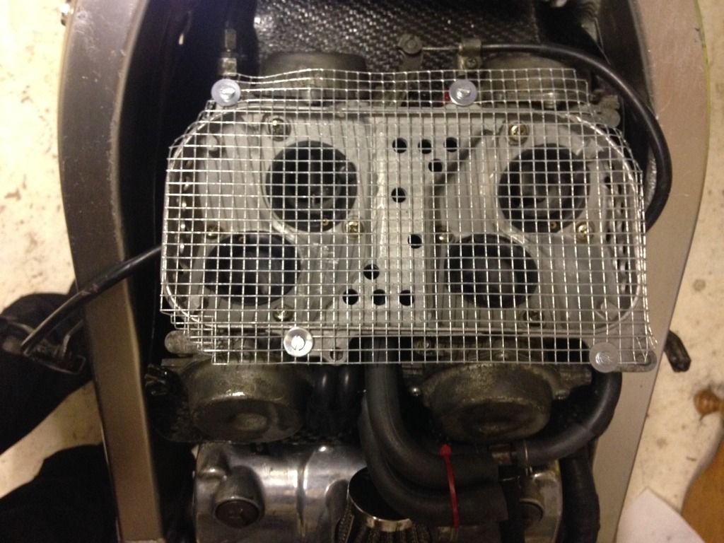

I used a sheet of this (as Rhory says) between the scoop and lid joint, then chain cleaner on the baffel plate to catch any bugs/dust.
This is how i run my HRC open carbs
