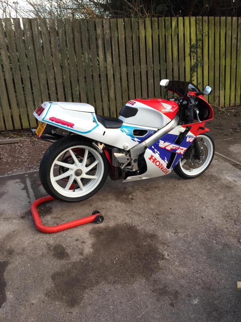

Evening all new to the forum, bought myself a honda vfr 400 nc30, which I can honestly say is so much fun to ride wanted one for years and now I own one.
The problem I have is when I had the bike on the stand this evening I put the bike in first gear, held the clutch in and noticed the back wheel was spinning, At first I didn't think to much as this can be the norm, until I though it was going a bit too fast. So decided to press my foot against the tyre and it made no difference and no sign of slowing the wheel.
Now is this normal for it to be spinning fast or should I take it in to local bike shop.
Any help appreciated
Pic of bike
Pic of bike
