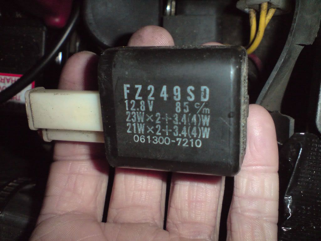

just a quick (and probably stupid sounding) question...
just upgraded to LED indies and need to replace the flasher relay... but where is it? :S
under the seat? or is it hidden away under the frame above the engine?
many thanks

Under the seat towards the back. Rounder looking with 2 wires (2-Pin relay) and rubber strap round it.

FYI 2 pin auto flashers ork fineTeamGSXR wrote:Under the seat towards the back. Rounder looking with 2 wires (2-Pin relay) and rubber strap round it.

is it the silver cylinder? because that has 3 wires ocming out of it

That sounds like the starter relay maybe? If it has 2 quite large wires it will be the starter relay. If I remember tommorrow (or is that today as it's 2am now) I will have a look for where mine is exacly on the GK73, which GSXR400 do you have anyway?

have a GK76A.
dont want to end up spending a score on the wrong part. im a student and as such im on a very tight budget. £20 is alot!!! lol

That's where and what my flasher relay looks like in the GK73, don't suppose the location would be the same but it should look about the same I would think.

thanks alot!! very helpful :D
