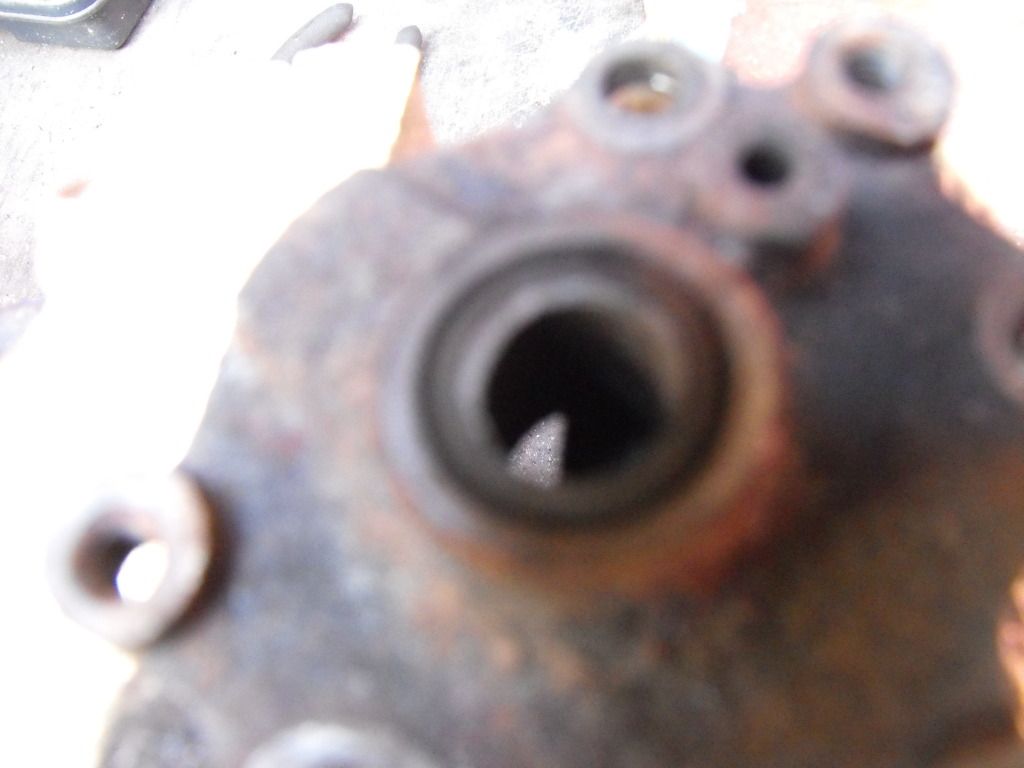

When I purchased this bike the seller had been told that the camchain was in need of immediate replacement and when starting it for me initially he referred to the rattling, tinkiling sound.I had experience of the worn exup bush being mistaken for camchain wear so knew what to expect here.!!
Firstly remove exup valve assy.
Next remove the 5mm bolt that retains the pulley flange .
Removed.
Then drift out valve carefully to expose severely oval graphite bush (very poor photo)
Removed.
