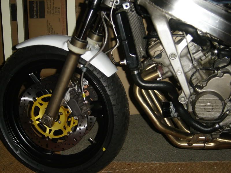

This is relatively simply - below are a couple of pictures from my Personal 2011 Street Stocks Championship Winning Tri Arm.
100% stock engine / standard CDI - fresh MOT - genny fitted - road legal machine.
if interested how to do it - just call me or give me a number - I'll call you back.
GF carb mods / air filter mods / Exhaust .. away you go.
