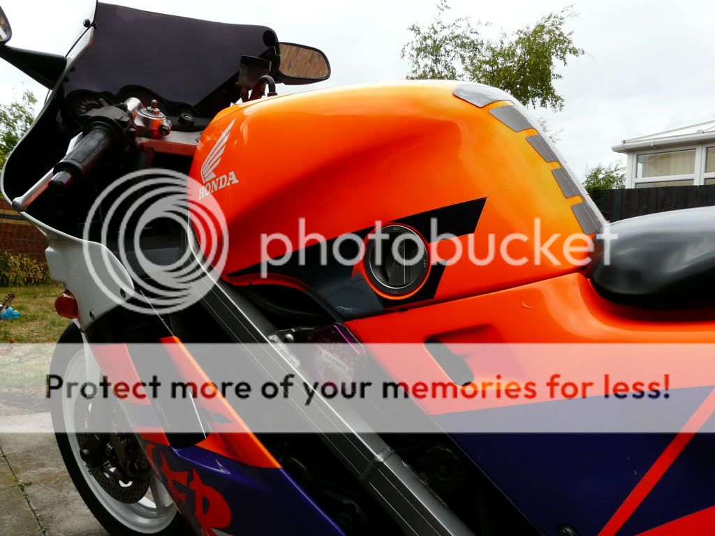

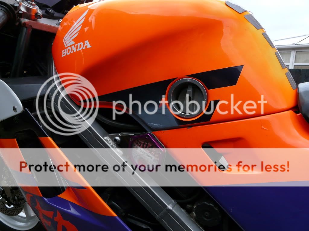

Re: NC24 Petrol tank leaking
The hole is now repaired but im not getting the paint done just yet, in case it leaks again, so i have put some primer on it to protect the metal.
While it was being welded it caused a hole on the underneath aswell...
Its only rough but when its painted and filled it will look all nice and new. Ane here it is on the bike, doesnt look as bad as i thought it would, so im happy for now.
IM now going to get the white tank sorted and sprayed NH196 white so i can then change if i need to.
Any comments welcome
