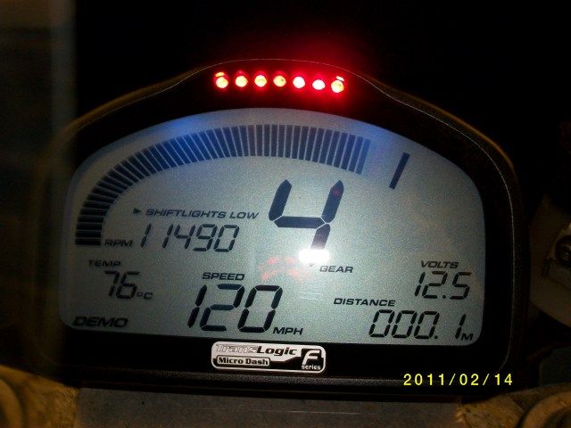

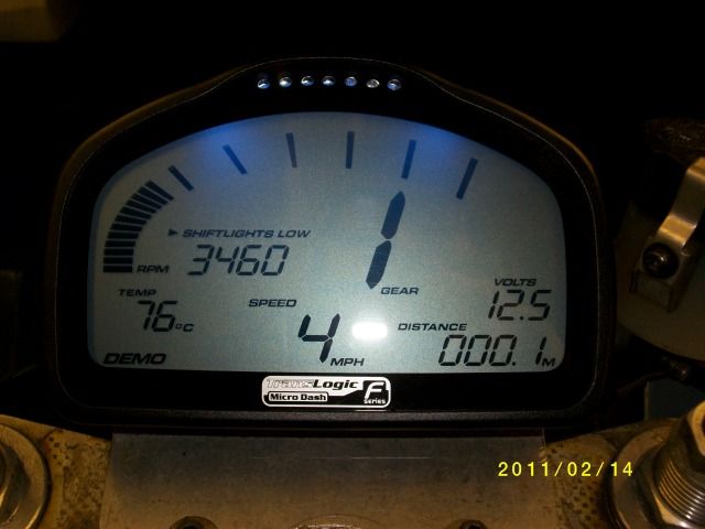

Couple of pics of my dash.

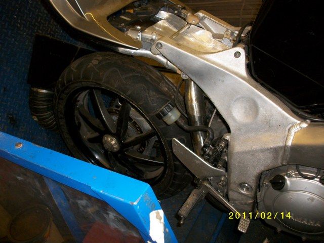

And a couple of pics of the bike,
Well some detail shots anyway.

hunter...................that is a fecking sexy dash,just what im thinking for my bike.
