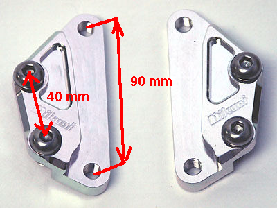

Re: 320mm brake discs to NC29. Possible ?
I having brembo 4-pistons calipers. And thinking to buy this sort of brackets
, but this is for Hyabusa and fit for 320mm bracke disc.
What do you think ? Is it possible ? Which discs I can use as donor?

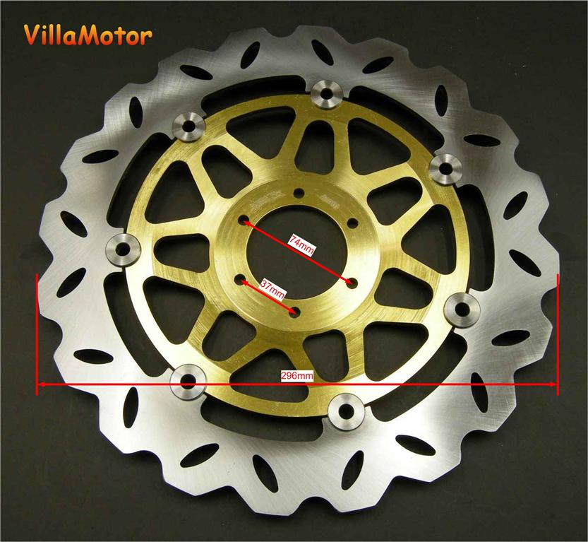

I found that ducati and cbr600rr use 320mm brake disc rotors, but not sure that they have same dimensions between mounting holes.
Ducati
Honda CBR 600 RR
Honda CBR400RR NC29
Any ideas?
Ducati
Honda CBR 600 RR
Honda CBR400RR NC29
Any ideas?
