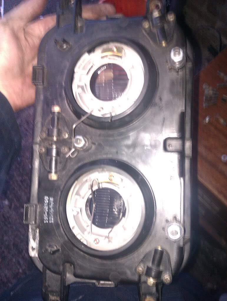

one of the points i find odd. (Front position lamp missing [1.1.1a] )
dont have one on bandit and that past :S anybody bodged this up? had a look at morris lamps and mine are diff.

Regarding the lights im sure they have adjustment, download the parts list from the manuls section and see if everything matches the diagram.

i sorted the lights out now, bought shiney new downpipes.
