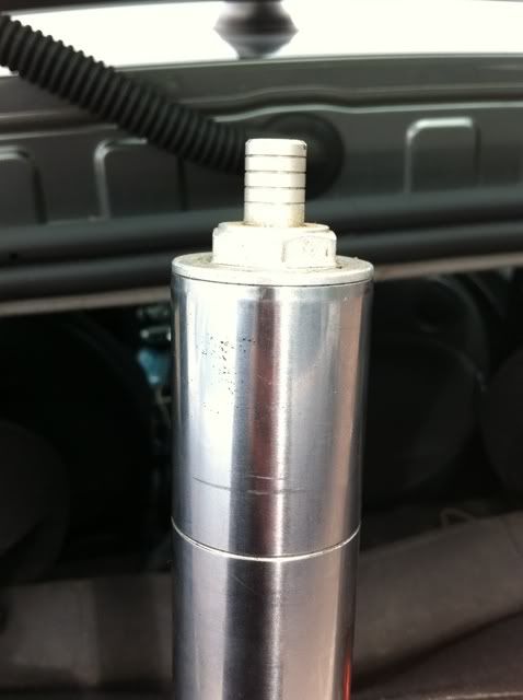

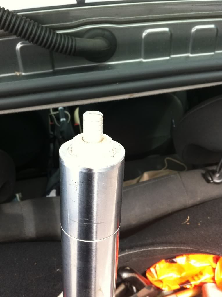

Ok need a little bit of help, i bought a vfr400 that had these forks on it, the sliders are cbr400 and had cbr400 sliding calipers on them, but im unsure if its a vfr fork with with cbr sliders or a full cbr fork?
if it is the full cbr fork its for sale as i want to revert back to the later type cartridge vfr fork and calipers.
Any guidance appreciated.

Measure the length top to bottom, VFR forks are longer (I think).

Sorry did that and meant to put it in the orig post, they measure 750mm from the top to bottom.

Why would someone put these on a VFR? Maybe to steal the originals, but before you assume these are inferior damper rod forks, have a look inside - they may be cartridge forks from an R model NC29.
