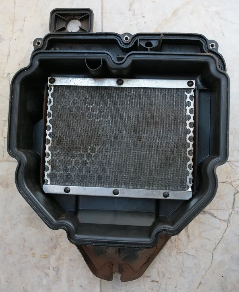

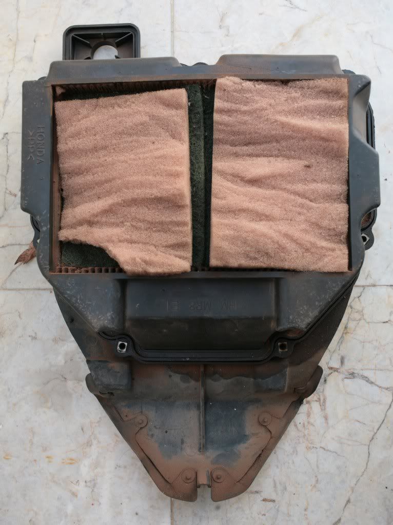

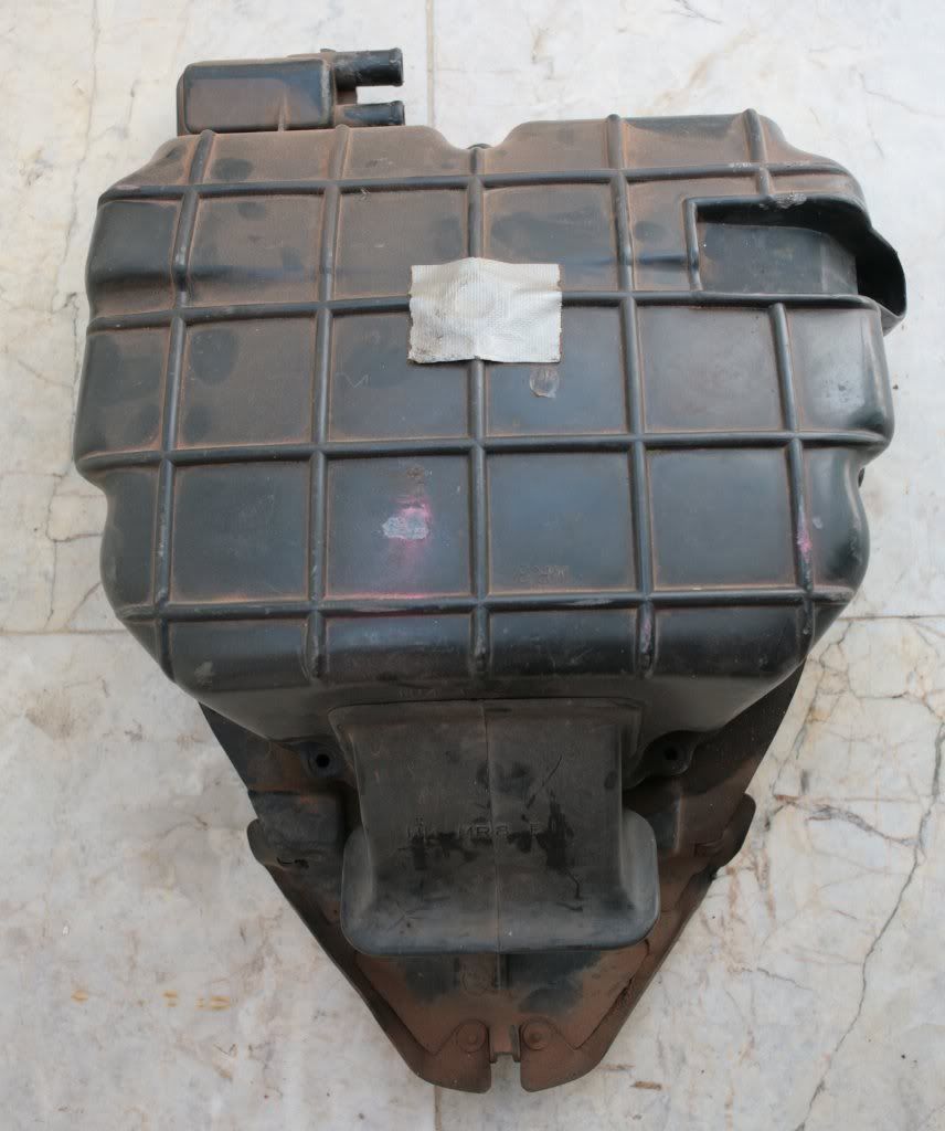

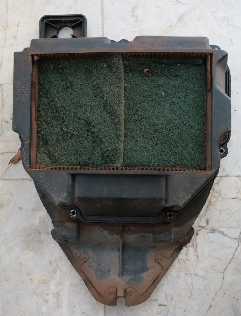

Rick Oliver said, "Return everything to standard." Wise words. Here's what was lurking in the air-box.
Frankly, I'm impressed at the ingenuity of the Thai mechanics. When it comes to keeping an NC30 on the road, they've tried everything. The inside of the air-box was completely clean.
Needless to say, the Scotchbrite pads were replaced with some of Rick's foam, same for the sub-filter.
